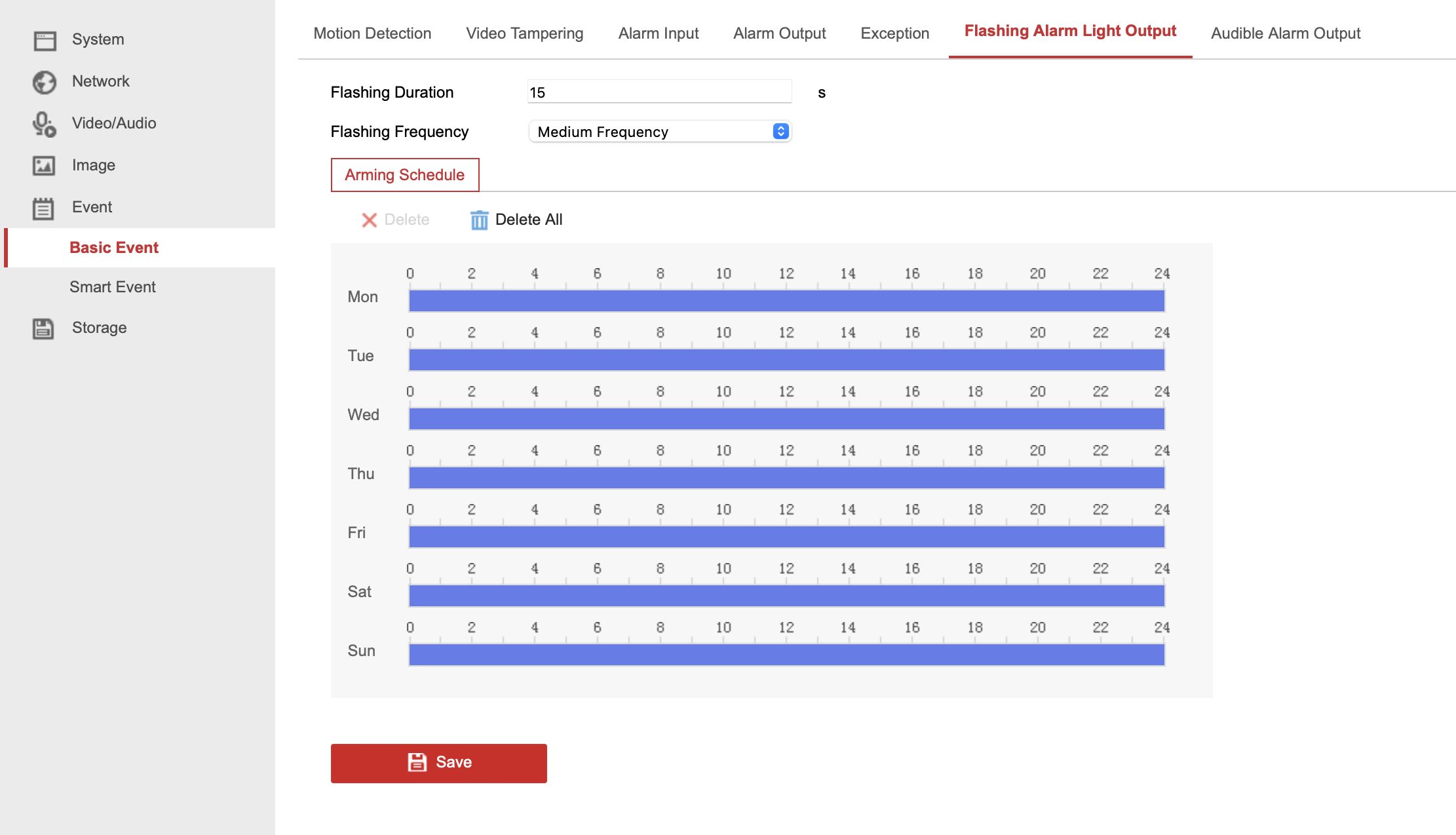

It should be possible if you configure the event as normal in the NVR for Line Crossing with siren and/or light as the linkage action. Once that's done, access the camera directly and set the arming schedules as required. They're configured in the basic event section (see screenshot) but I'm assuming that if a smart event triggers the schedule will still apply. I've not messed around with these settings myself as I don't use those functions. You should be able to schedule the alarm event itself if it wasn't wanted 24/7, then further adjust the schedules of the strobe light and audible alarms separately.
