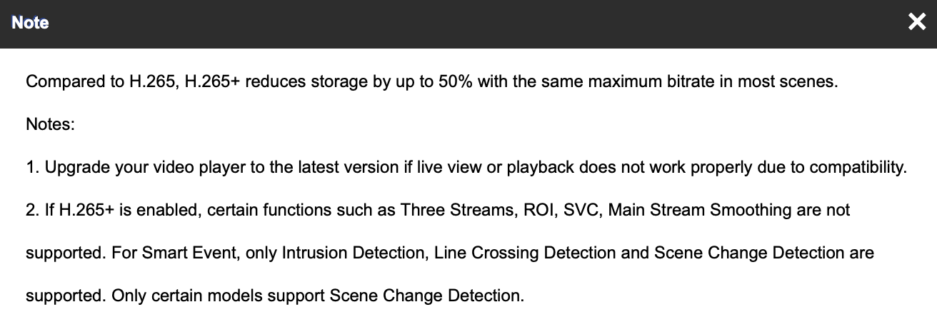

It looks as though ROI is not supported with H265+. This pop up appears when switching to H265+ on a G1 model:

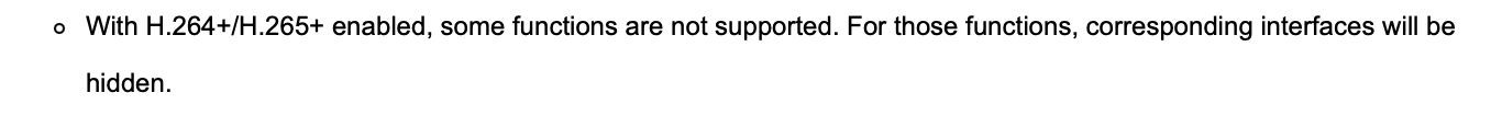

You don't get the above popup when you switch to H265+ on a G5 model. However if you look at the notes in the 'Help' link, you'll see:
While it's not clear which 'functions are not supported', I'm guessing that ROI is not supported with H265+ on any model. Perhaps, as the note says, the ROI interface should be hidden if it's not supported, to avoid confusion.
