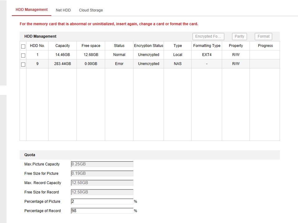

I also have the same camera model and it only has firmware bugs, I have never experienced anything like this with any Hikvision camera until now, the camera is set to record on sv nas and when the hard drive is full, the camera does not know how to overwrite the hard drive with all as it is set in the settings, I'm starting to regret that I bought this camera model, the first colorvu model didn't do that, I changed the previous model thinking that this G5 is better

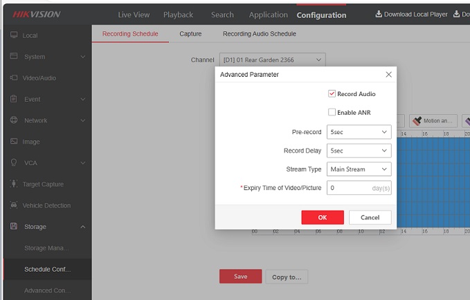

As mentioned back in July, I have been experiencing a 5 second delay, more of a frustration than an issue. Your mention of pre-alarm time got me thinking.
I have delved into the 'M' series firmware to check the pre record settings (I assumed it to be 10 sec by default), and noticed 'Pre Record' is set to 5 sec and 'Record Delay' is also set to 5 sec (neither has been set by me).
Of course the help file is useless as there are NO help notes for the Advanced Parameters, and now wondering if one parameter is conflicting with the other.
Previously Pre Record and Post Record were always set to 10 and 30 seconds respectively by default. These 2 values should dictate the recording clip duration before and after the event trigger and would be used when recording by event rather than continuous. I used to set Pre to 0 and Post to the minimum allowable when using continuous recording, as the Smart playback of the NVR used to add a 5 second run in to the event automatically in Smart playback regardless of the Pre setting (Event Playback may have respected the settings) I now use 5 seconds Pre, as this gets added before the trigger when viewing Hik-Connect clips)
Record Delay is likely to just be a renaming of Post Record. I’d not noticed that change but will check mine. The previous descriptor made more sense. There does occasionally seem to be a little Chenglish in the UI’s and Help files…
Edit: Confirmed. The parameter is 'Post Record' and remains the same in the local GUI, it's just been renamed to 'Record Delay' if you access the same parameter via web browser.
Thanks for the comprehensive explanation which makes perfect sense.
Yep... 'Record Delay' is confusing (why change its description?). I remember the previous NVR had pre and post record which is why I was thinking, after seeing that param last night, the delay param may be what was causing the delay.
