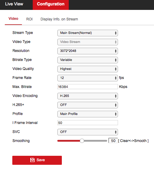

2363 IN CAMERA settings

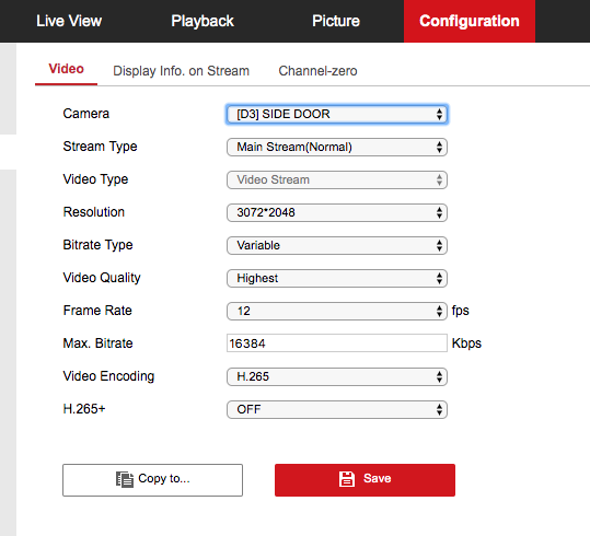

2363 IN NVR settings

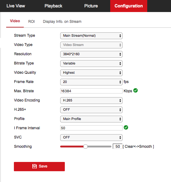

2385 IN CAMERA settings

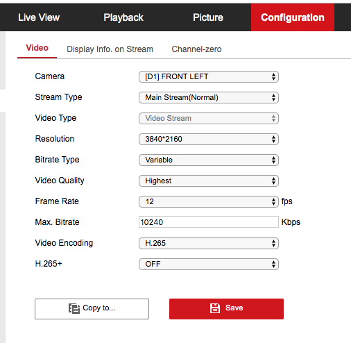

2385 IN NVR Settings

Did you get a chance to check my camera settings ? I want to ensure I’m getting the best out of them and I’m not sure how high to set bitrate as well as the other parameters. If you can advise I’d appreciate it
Many thanks
Thanks Dan great reply and has clarified things for me.
Many thanks
Most of those settings look fine, the only thing we would recommend is setting the frame rate to 15fps for both cameras as this gives you smooth images (very little gained by going to 20/25fps unless you are recording very fast movement like cars) and makes the best use of your storage/bandwidth. In regards to bit rate we usually just recommend leaving it at variable for most systems, variable bit rate allows the bit rate of the camera to increase & decrease based on the complexity of the scene and how much bandwidth it needs to use and using variable keeps the video quality fixed while the bit rate adjusts, constant bit rate does the reverse and so video quality can be reduced if you set the bit rate too low. Simply put for a small system using variable bit rate will get you the best performance from your cameras.
The final thing to mention is compression, I can see you are using H.265 on both cameras, you can increase the compression of both cameras to H.265+ compression which reduces storage and bandwidth usage by around 60% over H.265. The only downside to H.265+ is that it is a unique compression CODEC to Hikvision and thus the downloaded compressed footage does not always playback very well on standard media players and you may need to use Hikvision's own VSPlayer to view any downloaded footage. If you have the storage capacity you may be better off leaving the cameras recording using H.265 because this is a more universally accepted CODEC and most media players like VLC will support H.265.
