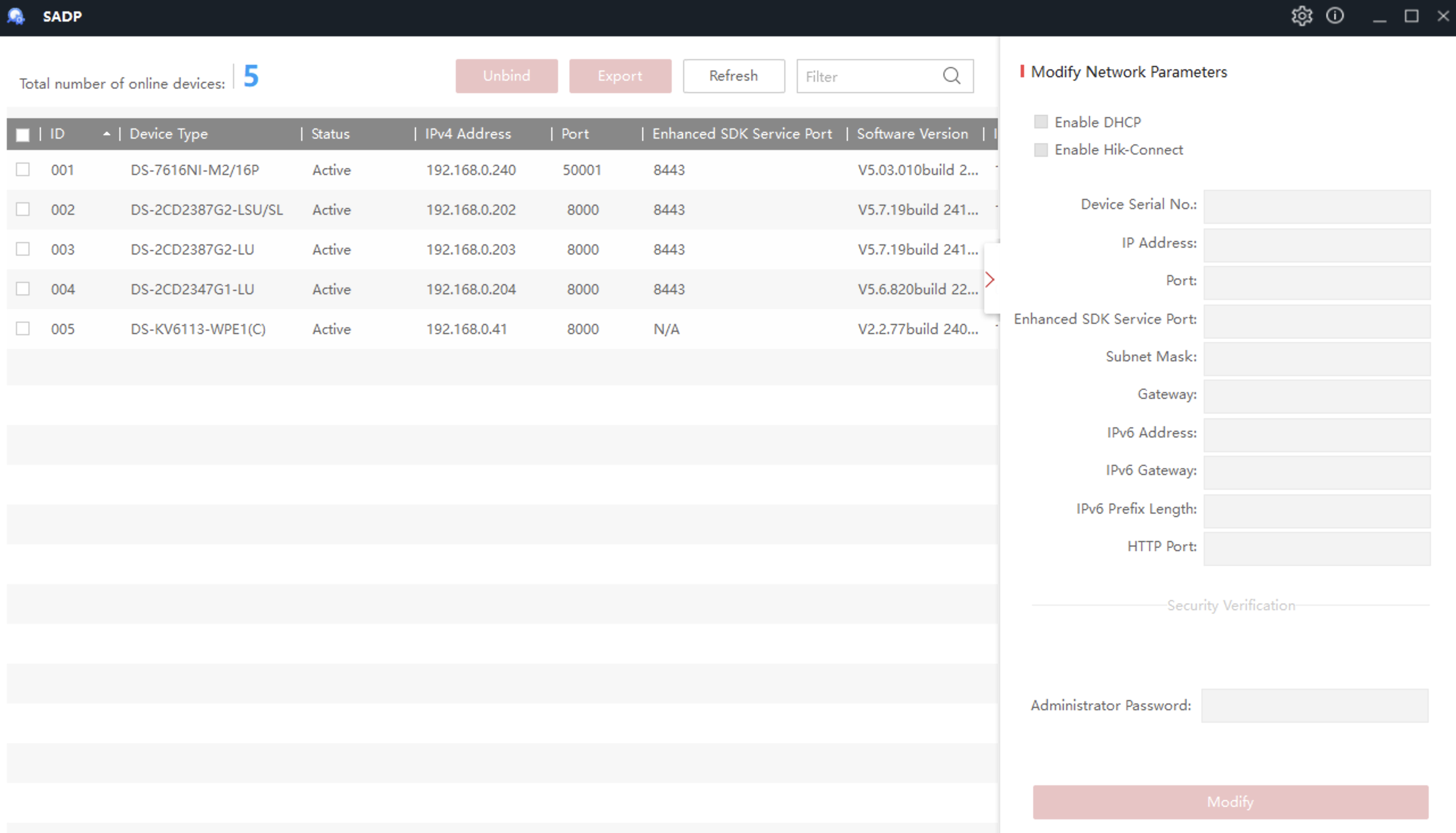

Assuming 1 and 2 are ok. You would just download the Hikvision SADP tool on a PC/Mac that's connected to your network and run it. If the device is present it will show a screen like this:
You would just tick the box to the left of your entry for the NVR, tick the enable DHCP box, enter the administrator password and click the modify button. That would get your NVR accessible on your new network and it should then work with Hik-Connect again. Ideally you would set a manual address and also change the DNS server to 8.8.8.8

I have downloaded the SADP tool as advised and tried to go on to modify the details, but as you say, they administrator password is saying it is incorrect, so the installer has obviously used a different one to set the NVR box up! The annoying thing is they did write the P/W details and encryption keys down for me, but must have used a different one to set the NVR up!
