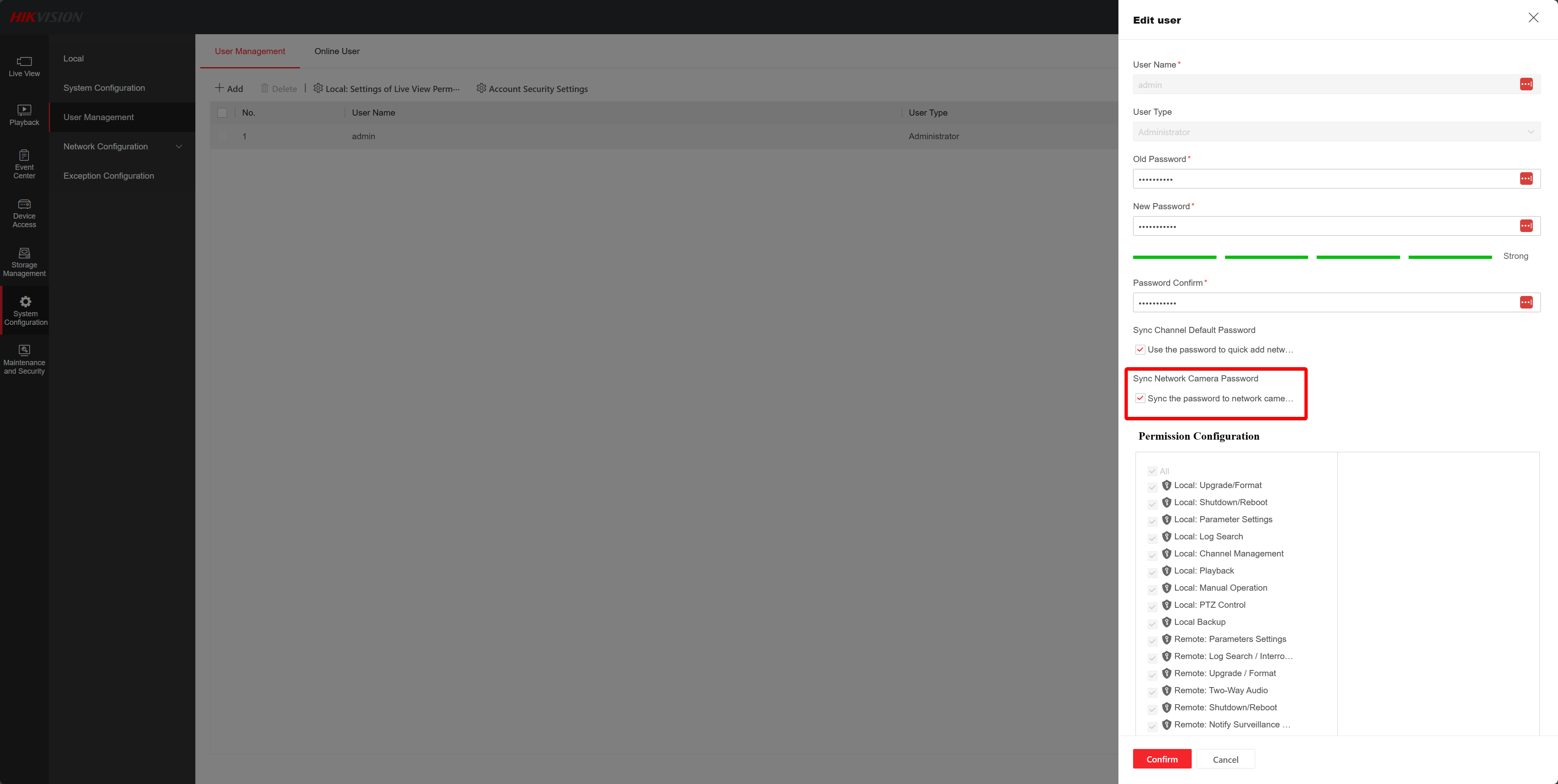

It looks like you can change the NVR's admin password and tell it to apply the same password to all of the Plug & Play cameras.
If you go to (on the V5 web GUI) System Configuration > User Management > Select "admin" > Edit (the pen button) ...
You can use the flyout to set the password, and also tick the box circled below to carry that password over to the cameras.
You'll need to make sure the box above is ticked, or it will stay greyed out:
Upvote 0
Thanks. Mine is still at v4.50 but is similar - checked the relavent bits, one password change and it seems* to have gone through to the camera okay.
* checked most of cameras now working with the new password but I did see a brief error message (re GUI) when completing the task (unable to read it) and one camera seems odd (not talking directly to me) - but I'll work on that to see what might be wrong.
