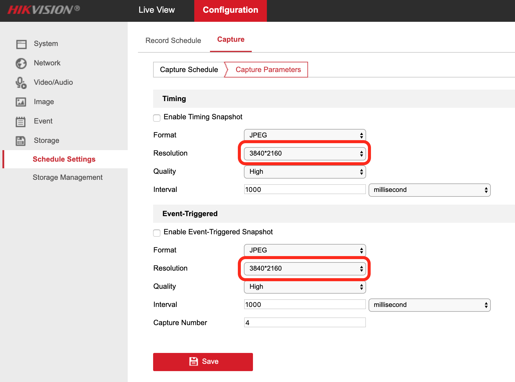

Looks like the capture parameters allow you to set it so maximum resolution when logged into the camera directly - so ignoring the NVR capture parameters and setting up all events/enabling snapshots on the camera only. Here is the full resolution option when logged into an 8MP turret:
The file size restrictions seem to be down to the NVR's processing limitations, so the above settings will still send the captures via email/FTP in full resolution, as they will be sent straight from the camera.

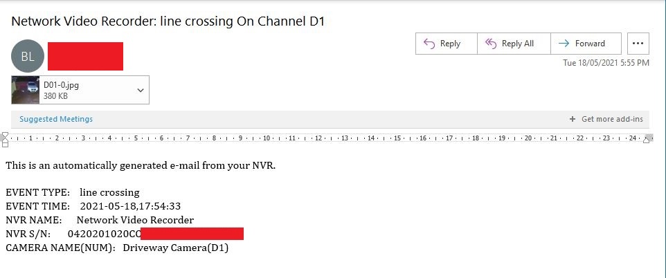

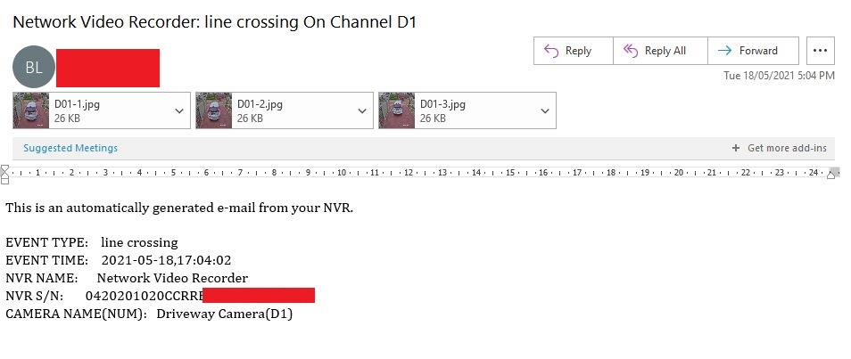

I have a DS-7604NI-K1/4P-B NVR with 1 Camera - (Acusense DS-2CD2386G2-I) connected to it. Both items have the latest firmware on them as of 22 May 2021. I have been trying to resolve the 3 images by email issue for almost a week and am ready to give up. I have noticed that when there is "limited light" intrusion events, I receive 1 image of around 400kb to 520kb sent by email via the NVR. During the day (even when it is a cloudy and overcast) i receive 3 small images of around 27kb each. The small images are next to useless and I would prefer just 1 large image.
I have tried many combination of changes and am at a loss to fix the problem. The people that I purchased the NVR & Camera from here in Australia have offered numerous suggestions - from Hikvision Technical Support - but nothing has worked so far. Surely this cannot be so complicated and if Hikvision can't resolve the issue who can?
Hi @BLOZ
We have discussed this issue with Hikvision support previously and the latest information we had was that Hikvision now only supports 1 image being sent via email and that there is no way to change this. We have never encountered 3 images being sent during the day and 1 during the night for the same event on the same camera.
Hi Dan,
Thanks for the reply.
Find attached "snip" of email showing 3 images (27kb each) being sent at 17:04 and then a "snip" of email showing 1 image (380kb) being sent at 17:54. Same camera and same smart event (line crossing).
Hi @BLOZ
