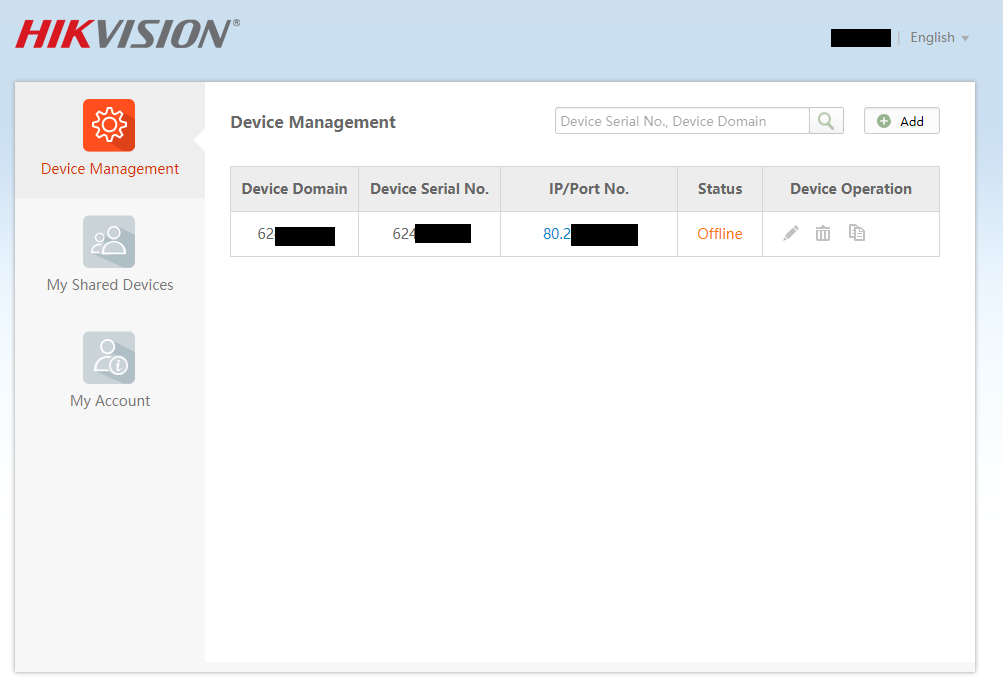

When you login, and select device management, you should see a screen similar to the below - with a table showing your device(s):
[and if all's well they will show as online]
Yes it does show this but we still cannot see a live stream on our mobile phones
Does it show (in the Hik-Connect portal, when you login) that your camera is online?
{in my example screenshot above my NVR shows as offline, for it to work your camera should show as online here}

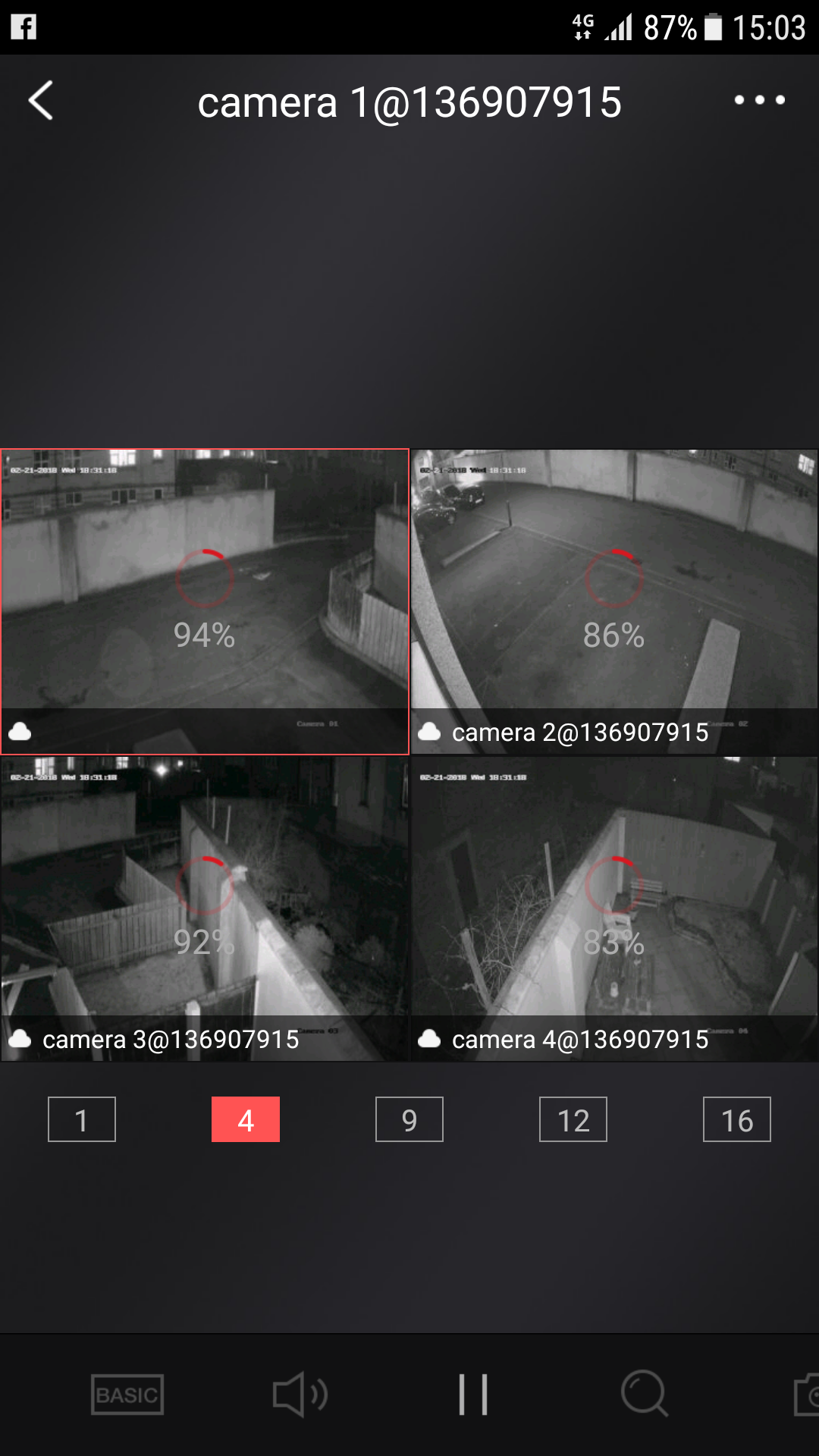

Yes it's shows online I have attached a file with the pictures that it shows when I go onto the app on my phone also this is old footage from 2weeks ago but it's still trying to load this
