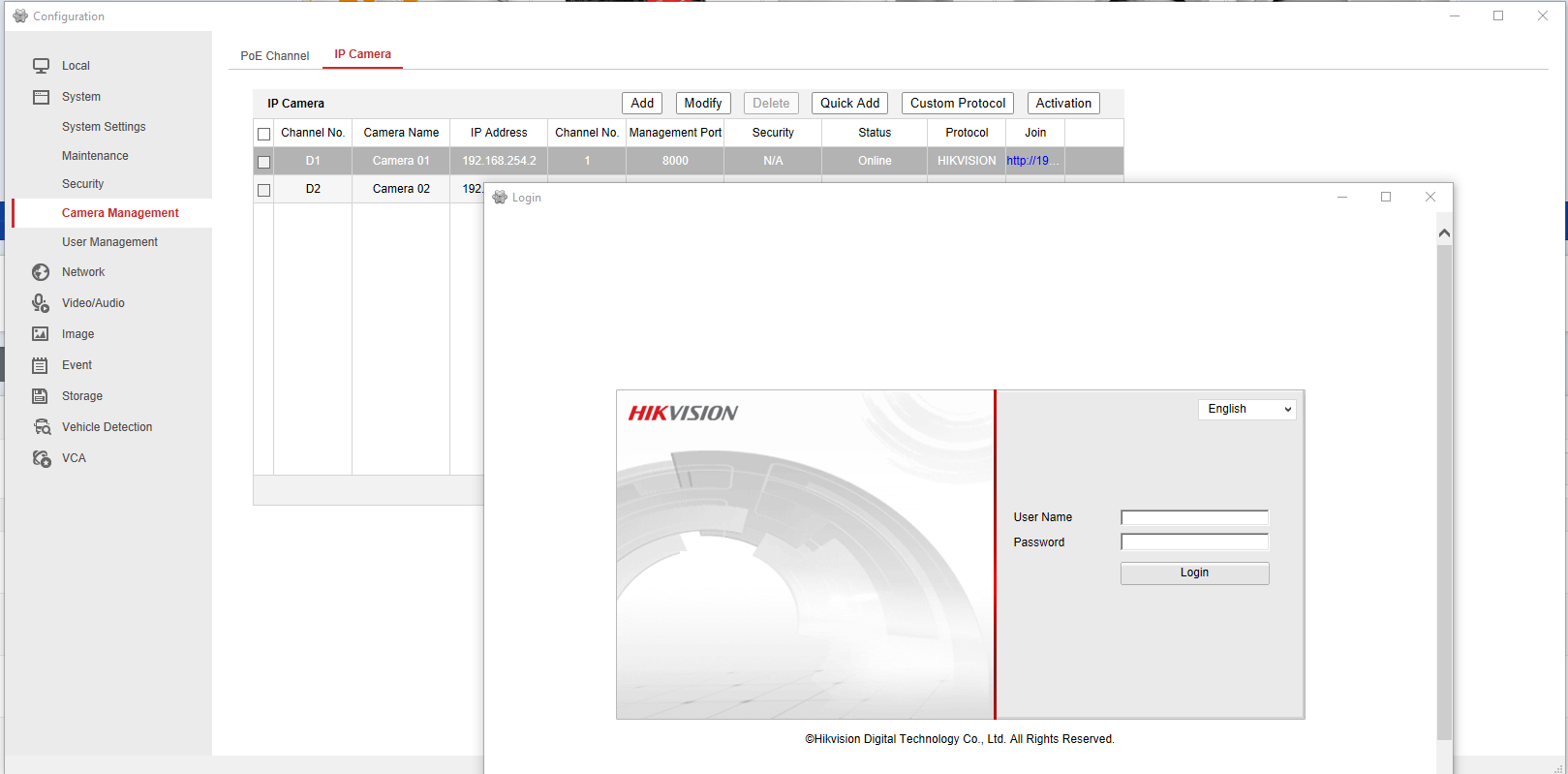

The I go to Camera Management in iVMS and try to access the first camera it all works fine and I can access the cameras webpage:

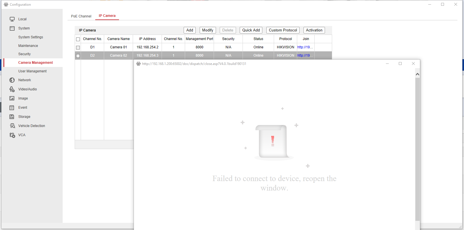

but when I go to the second camera, I get the following error:
Both cameras are online and live stream can be viewed via iVMS or a webpage.
Why cant I access the configuration?

Camera 02 is the problem camera.
