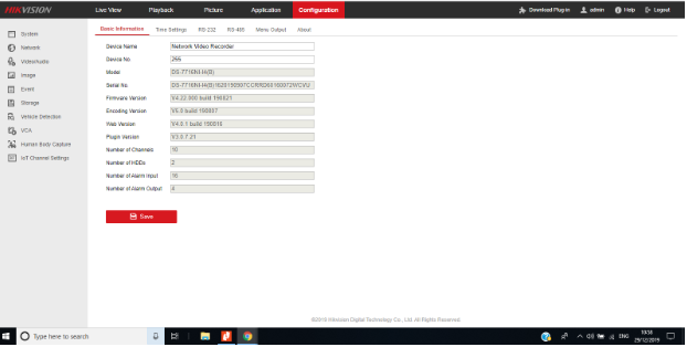

When I log into the Hik connect application - configuration - There is no 'local' showing as you can see below on the left hand side of the window, please advise?
Many thanks in advance
That implies you do not have the plugin installed. See the link on the black menu bar on the right hand side - if you install that then Local should appear.
This is a different plugin to the original IE one and isn't well designed - after installing your PC will prompt to allow this to run every time you reboot. Another one to feed back to Hikvision I think.....
