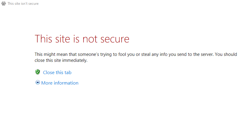

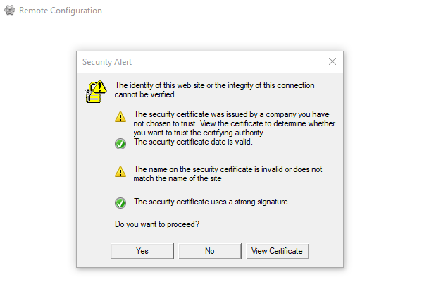

I tried on non-POE connection. Those are the messages for the iVMS4200:
If you select View Certificate, then you have the option to install and possibly proceed to login page.

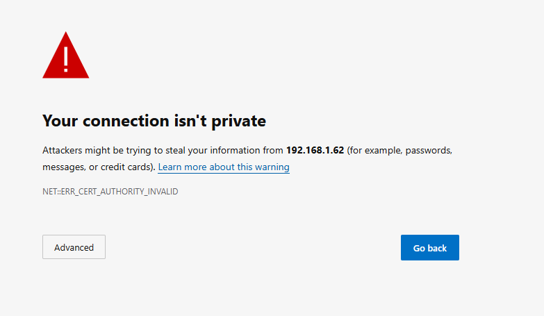

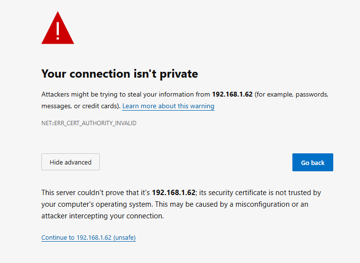

The other way that worked for me is the Edge browser:
You select Advanced and then Continue to 192.168.xxx.xxx and login page
