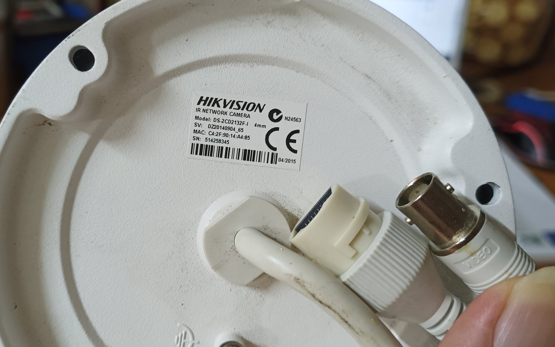

this camera contains BNC Port and POE Port, so is this allow to connect to NVR or DVR too??
I am curious how to connect this to DVR.... is it direct connect the POE to power adaptor and the BNC to DVR???

It's an IP camera so you would use the network connection direct to the PoE port of an NVR. The BNC is just a convenience allowing you to connect a service monitor while at the camera to aid in positioning. It's not much use for anything else as it will be a low resolution image.

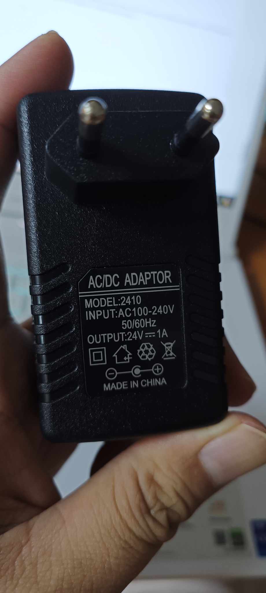

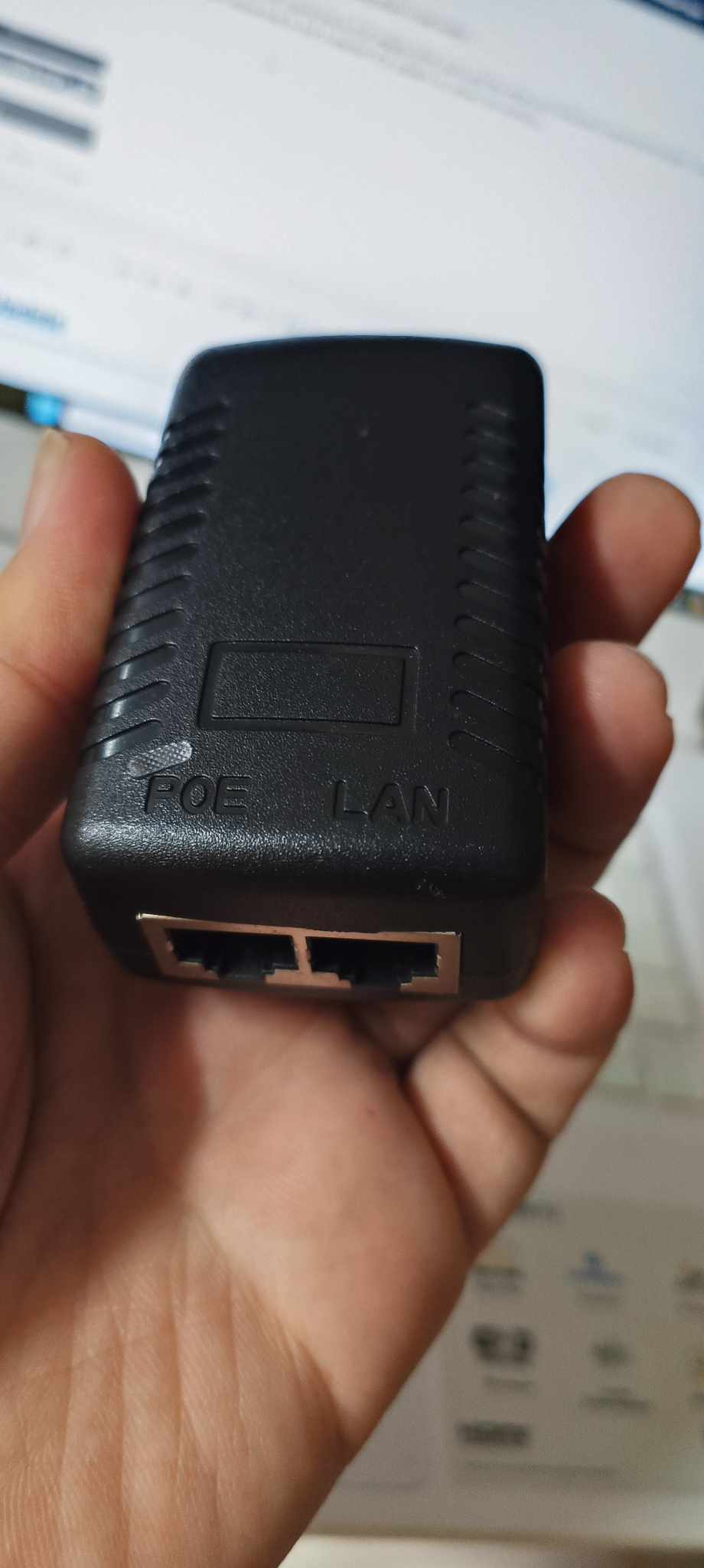

Actually I am trying to access the camera with my laptop for the setting where I read online.....
I also tried to connect] like what you said, Camera POE connected to POE adaptor (POE port), and the other port (LAN port) connected to Router... but not showing.....
DVR and Router are running properly, I don't know how to test it whether POE adaptor or camera not working.....

Thanks @Newbie here
When you plug the camera into that PoE adaptor, do you see any sign of activity from the IP camera? Do the IR LEDs around the camera lens light up for a few seconds?
Thanks @Newbie here
that the weird thing...... it seen not responding after I connected and tried with 4 cameras....
after that, i sent to my friend who working as technician in outstation and said all working and only didn't test it with DVR or NVR......
Or I need to try the reset button????
Okay,
You'll need to get your hands on another PoE Injector (preferably not the same model you already have) and test the camera on that.
If the camera doesn't work on the other PoE Injector that would suggest there is a fault with the cameras, if the camera does work on a different PoE Injector then that would suggest that the issue lies with your PoE adaptor.

Ermm...... I think that the only way.... So if all working, SADP should detect the camera if camera connected to POE adaptor and connect to laptop???
Besides that, do you have any online information regarding this kind of camera (combination of BNC Port and POE Port without Power Port)??? I search online and showed the combination for all the IP Cameras also POE Port and Power Port, no one with BNC Port.....
Technically yes, but as explained earlier we would recommend you connect the camera to the PoE Adaptor/Injector and then connect that PoE Adaptor/Injector to a switch or directly to your local router.
Connecting directly to a laptop can sometimes require some complex manual configuration of the laptop's network setting, removing the laptop from the situation will make it easier to diagnose if there is an issue with the camera and/or the PoE Adaptor.
