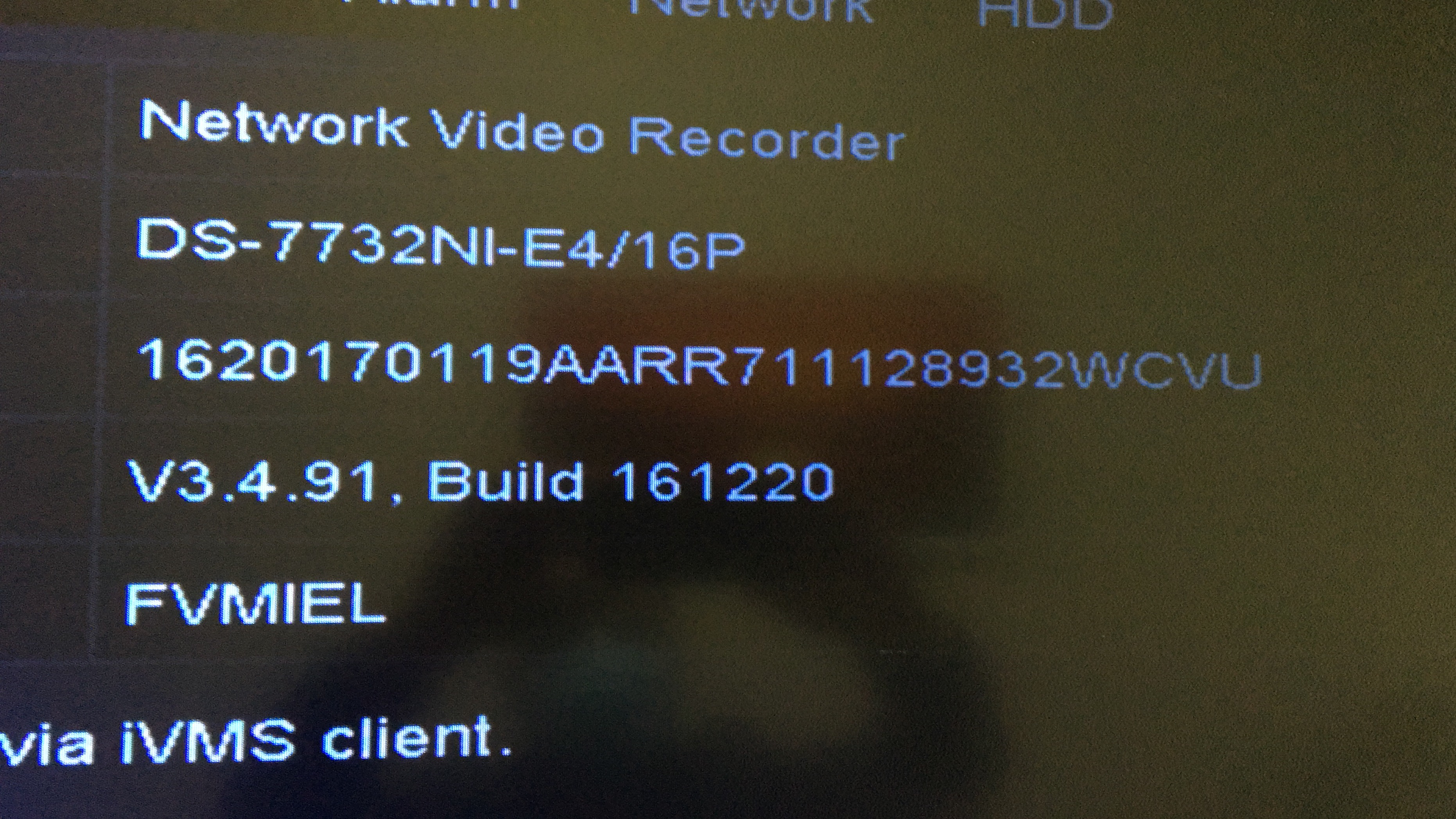

This is the model of the nvr
But i don t remember the dvr model
