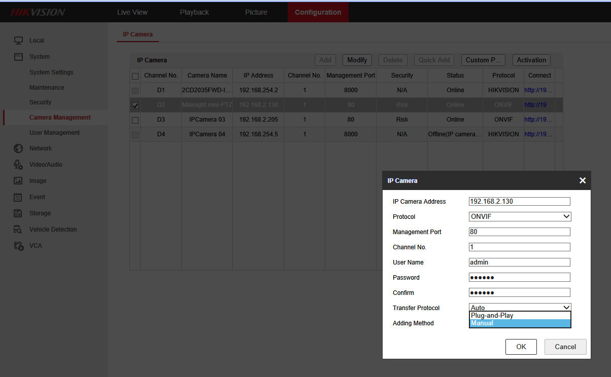

Yes, you can mix & match direct-connected cameras (plugged into the NVR's camera ports), and cameras connected to your general LAN. In the NVR's 'Camera Management' section in 'Configuration' you can manually add the cameras from your network (enter their LAN IP address, user name and password).
I the example image below, D1 is a direct-connected HikVision camera, D2 is a LAN-connected Milesight camera.
Note the differing IP address domain ranges between the two; one on the NVR' sub-domain range, the second in my general LAN domain range.
NB You cannot exceed the NVR's stated maximum number of cameras, regardless of how you connect them i.e. an 8-camera NVR will only manage & record a maximum of eight cameras.
