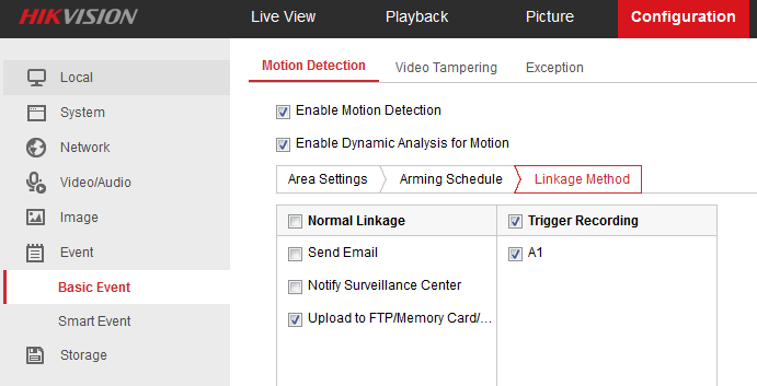

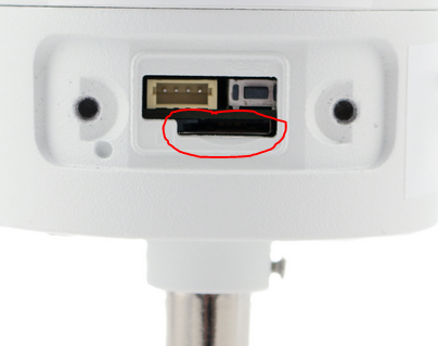

Hi Jan, the more recent Hikvision cameras allow you to record video on motion detect to the onboard microsd card, if you install one. I'm pretty sure the DS-2CD2042WD-1 does not have a microsd slot. If it does it would be on the underside close to the sticker with the serial info.
You'd then configure the camera to save the clip to the sd card.
You could try link your Synology NAS to the camera and save the motion capture videos there (I have never tried this). The instructions on connecting a NAS to the camera are on page 126 of your camera manual.

I don’t think I have an DS card slot. It’s mounted outside on a post. Is that card if there, accessible via the config pages???

Cameras like the DS-2CD2055FWD-I and DS-2CD2025FWD-I (EasyIP 3 range Hikvision calls them) have the sdcard slot.
