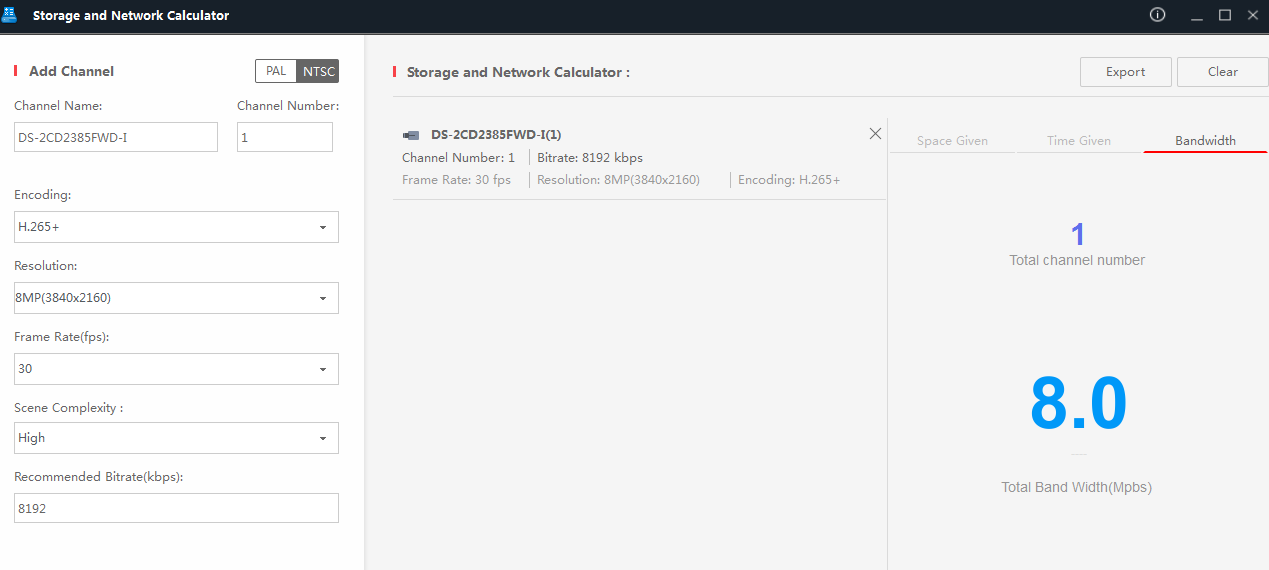

Even at high settings you should not see rates above 16Mbps. 30Mbps is puzzling. See attached image. Are all three streams active?
Hi, Stewart. I am running a substream at 2fps and Higher quality with max data rate 256k (for remote 3G access) but I don’t think that should have much effect. I’ve seen the calculators but I can’t seem to get close, at least not consistently. When I monitor the data rate on the bottom of the HDMI screen in real-time, it varies a lot. At night in particular the peak rates are often over the cameras max ability of 16m, so I get frame loss, sometimes for seconds. Not just one camera. I’ve considered a network problem but have disconnected all cameras/switches and added them one at a time, but can’t find anything. It’s a real pain as I’ve enough disk space to run higher data rates and quality, but I just cannot get the cameras to run it. Any ideas? Cheers, Paul
