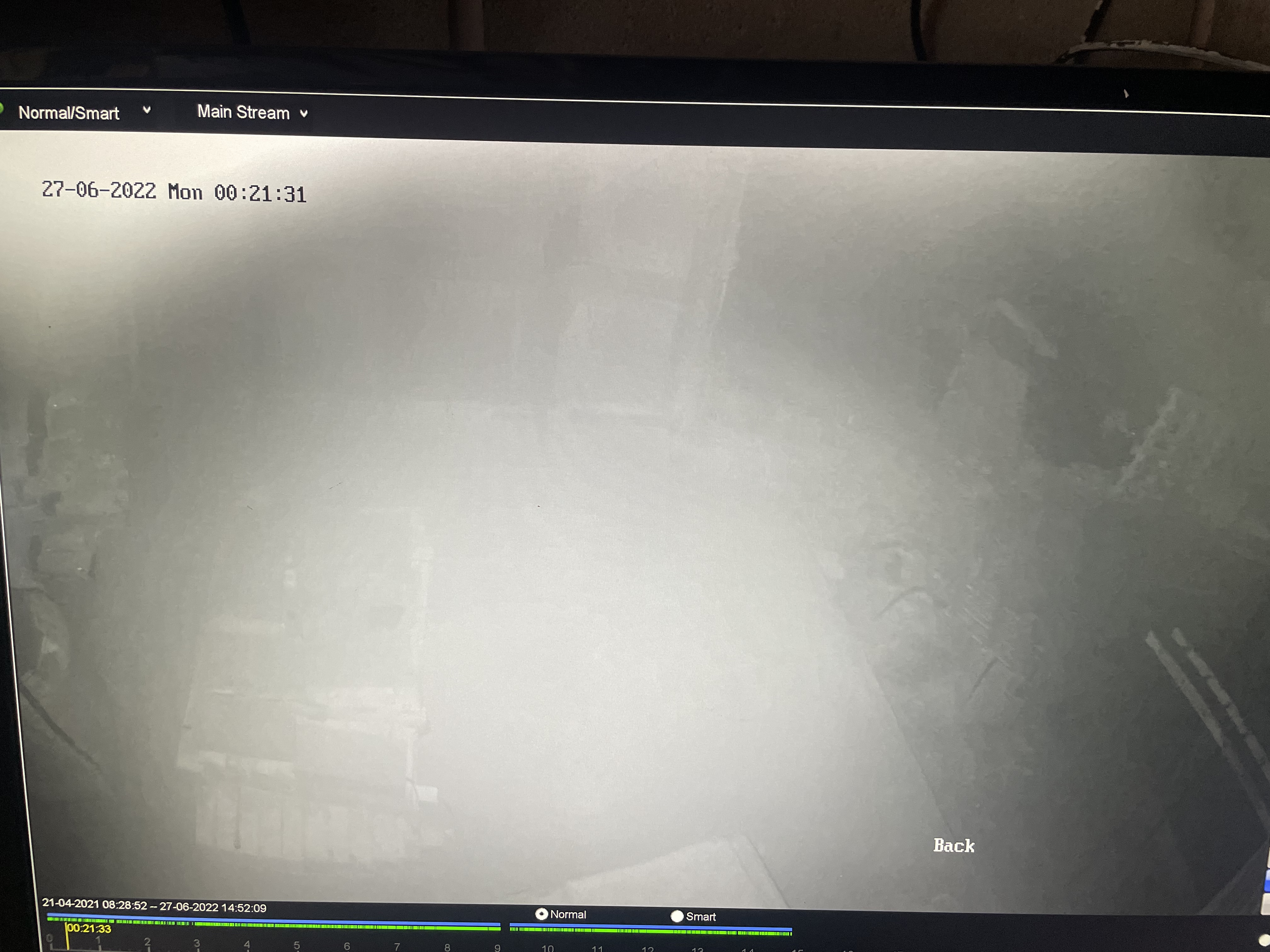

I have also noticed they don’t work at night either even the clear camera doesn’t work!

The second image looks like IR reflection - typically seen at night when you have dome cameras with built-in IR LEDs inside the dome bubble and issues such as a dirty dome bubble cover.
The first image may be just a lack of light - it looks as if the camera is trying to render colour images although there is insufficient light in the scene.

I tried new cable today mate still the same. It is very dark at the house but my last house the rear garden had no lights at all and still worked fine at night. Just don’t understand why it doesn’t work. When the flood light comes on the camera literally goes white.
I did playback again today and it looks abit better at night now. But when it turns light around 4ish the screen looks misted then clears up as it gets fully light outside. Strange!

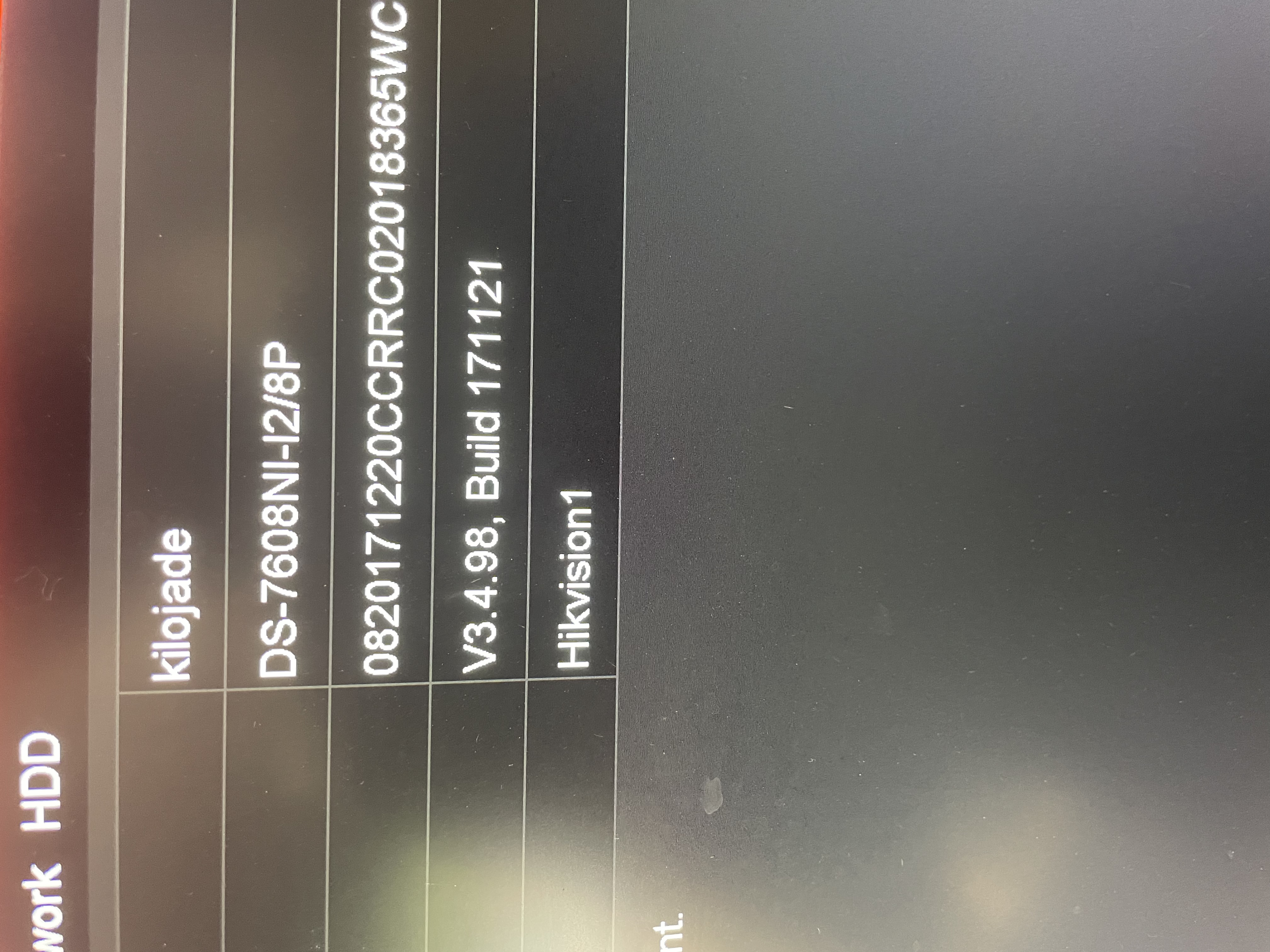

Hi @Kilojade
Can you login to your NVR & camera and go to Configuration > System > System Settings > Basic Information and confirm the current firmware versions of each device?
If you haven't updated the firmware for quite a long time you might be too many versions behind to update straight to the latest and we may need to link you to some earlier versions to update in steps.
Hi attached pics. Ignore the 3rd camera that’s just a spare I had. The top 2 I am not sure why the firmware info is different as it’s the same camera. I have 4 of these just the other 2 are that bad not worth putting up.

Thanks @Kilojade
We were quite shocked to see the firmware version your NVR is running, I can't remember the last time we saw an I-series NVR running v3 firmware (that dates back to 2017).
You are about 19 versions behind so you are going to have to do quite a few steps to get it up to the latest firmware, we've listed/linked below each firmware you should update to and the order to do it in:
V4.1.10 build171107
V4.1.54 build180621
V4.1.64 build190119
V4.22.005 build191208
V4.40.015 build200616
V4.50.000 build210125
V4.51.005 build210628
V4.60.000 build211129
V4.61.000 build220507
Update to each of these firmware versions one at a time and then let us know once you are running the latest firmware and we will look at updating the camera firmware.
