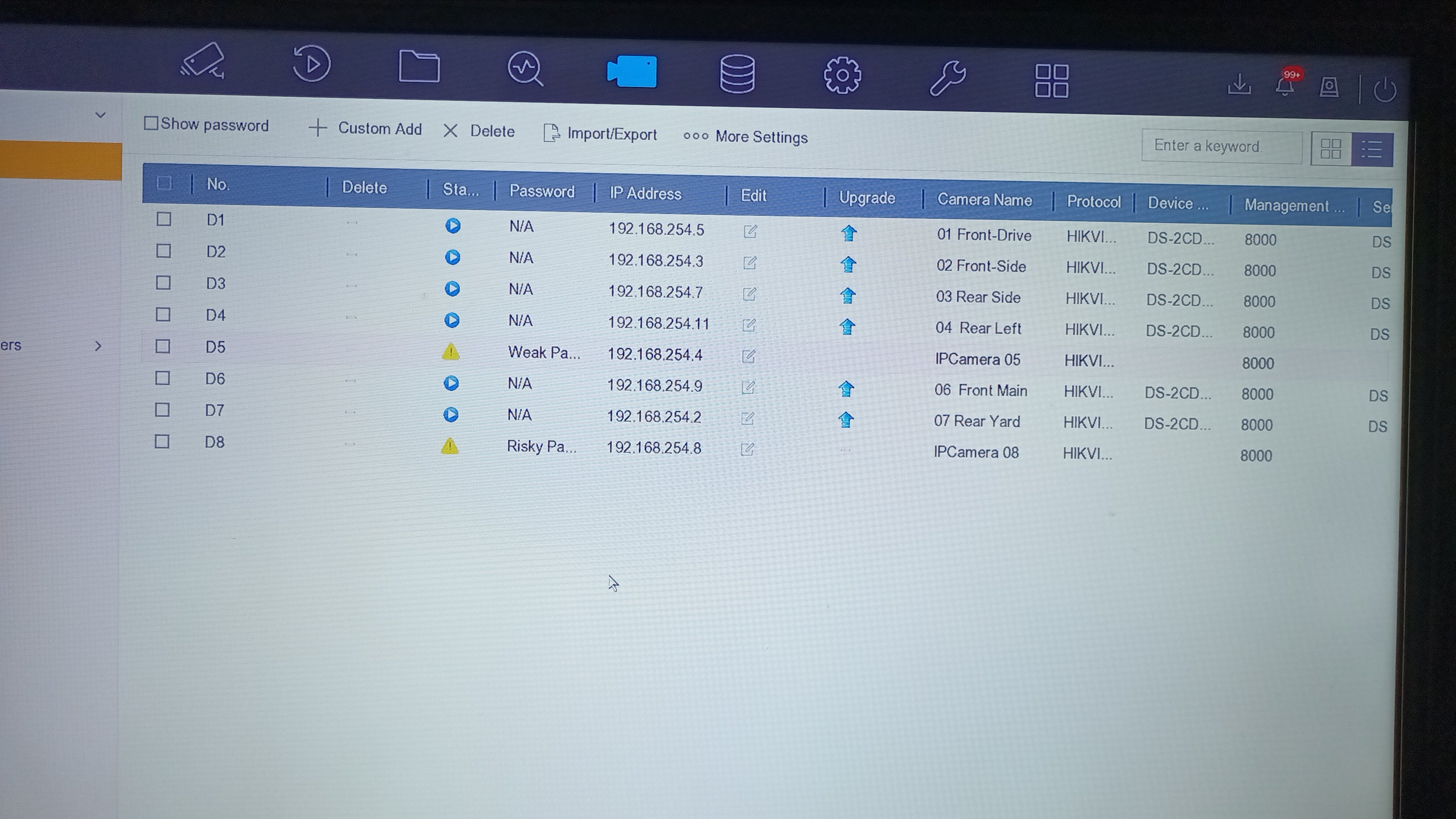

Can you please share a screenshot/photo of the camera management menu in the NVR showing the connected cameras and the one showing the error message?

Screenshot as requested

Thanks @Gwladok
You say "After I re-input user name & password I then got the network is unreachable", where did you input the username & password?

Okay,
So when you click that 'edit' button, is the problem camera set to 'Manual' or 'Plug & Play'?
Upvote 0
Okay,
Unplug the problem cameras, change the channels to 'Plug & Play', and then try plugging the cameras in again.
