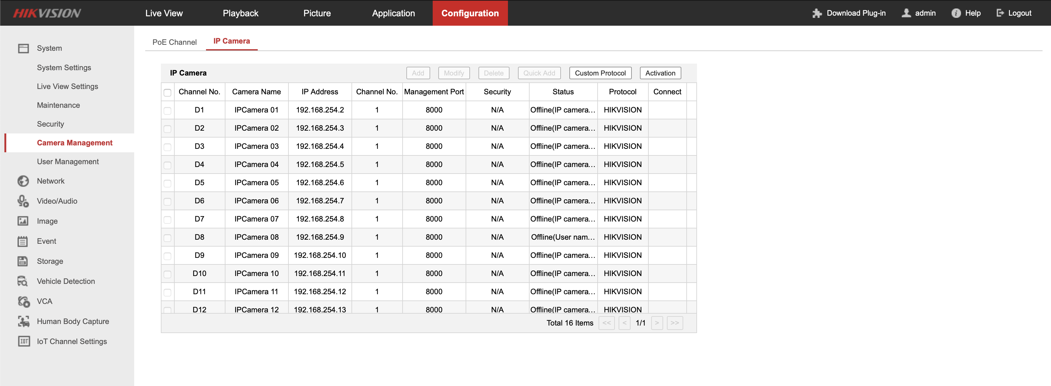

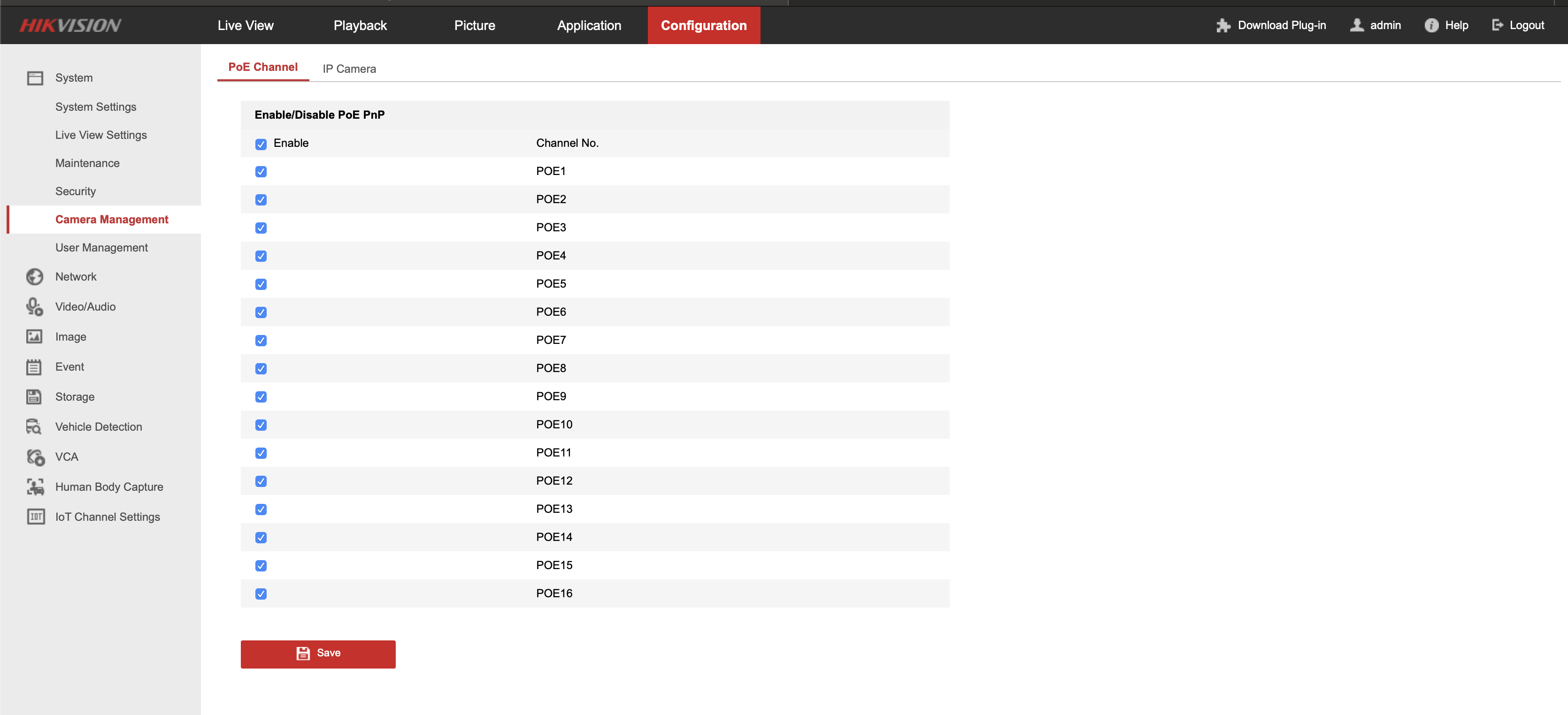

This is all I can see, I just cant get the cameras to go online.
You need to set up "virtual host" on your NVR. Do a search, there are a couple of threads on how to do it. I'm at work and can't offer much help right now.
