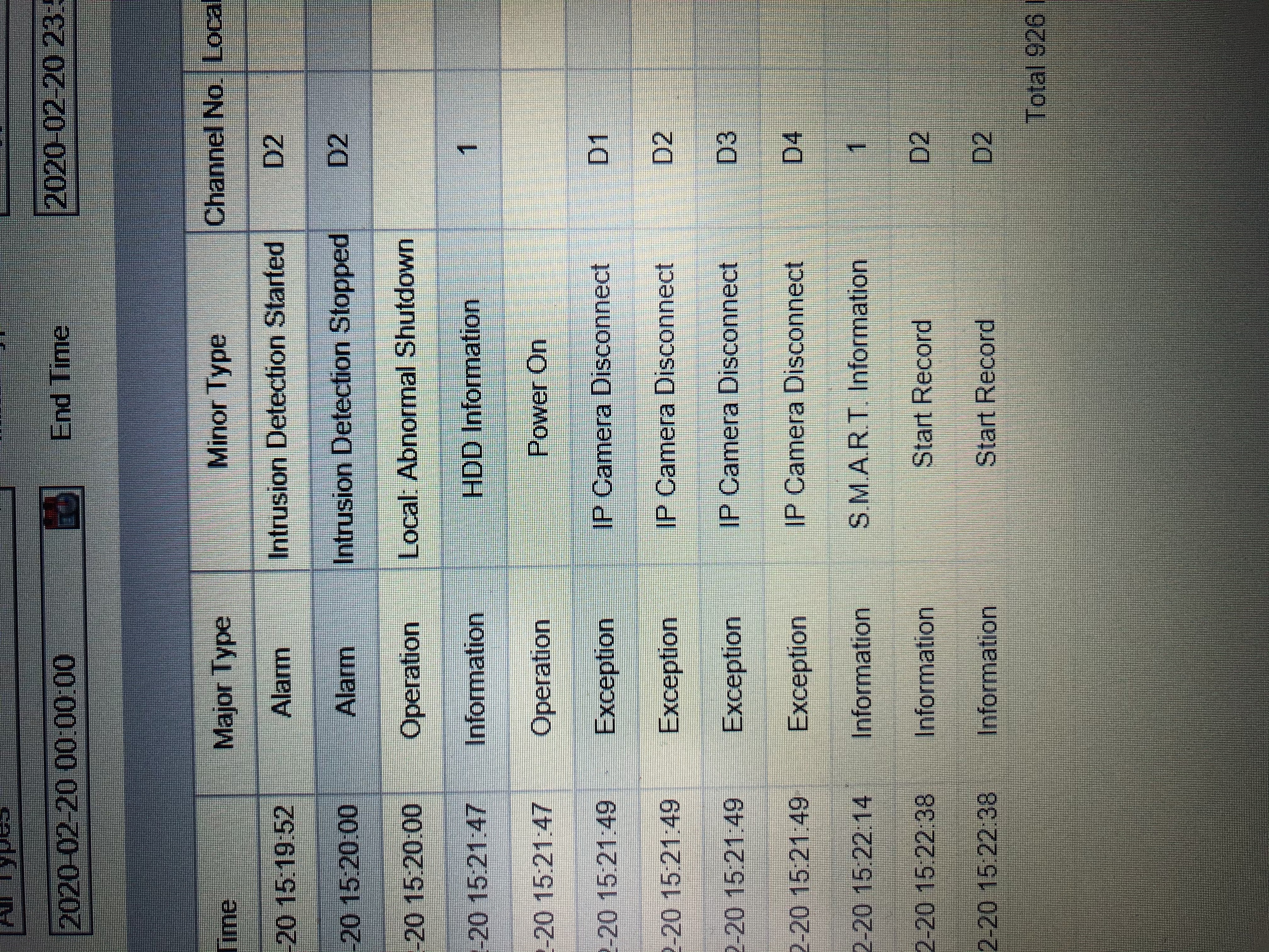

I’ve read somewhere else that disabling UPNP could resolve, although that was suggested back in 2016! I’ve attached an example of what I see.
Just to add, I have attached the below log.

I notice the shutdown seems to have been immediately preceded by an Alarm in that image.
Does that repeat? i.e. is it the case each time your NVR shuts down?
Do you have something wired to the NVR as an alarm?
I think that is a photo of your monitor, it's not easy to read.
Can you please capture a screenshot from your PC and upload it if you need to sahre more/again, thanks.

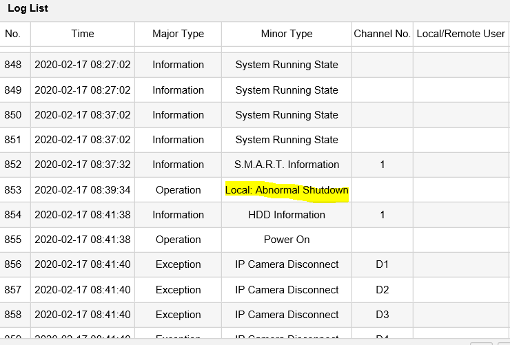

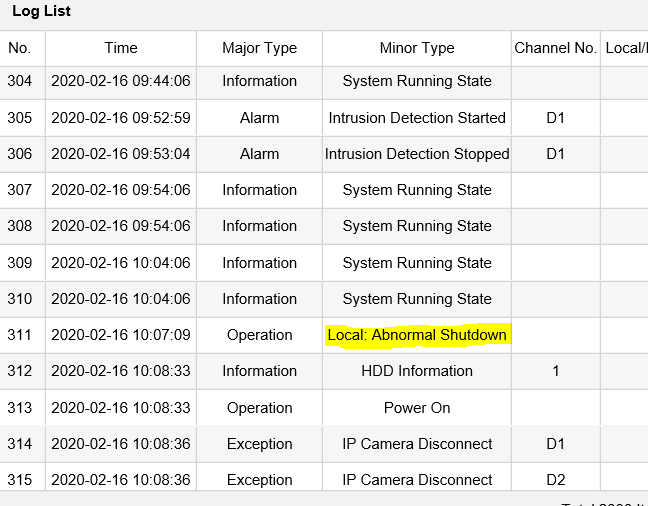

Thanks for the response Phil. You're right, I thought the same but after digging deeper I do have a few more examples that do not appear to be triggered due to alarm (see attached). I don't have anything wired into the NVR as an alarm.
My configuration is fairly straightforward. Contentious recording on both cameras, and intrusion detection on both so I can be alerted via Hik-Connect.
Could the attached logs rule out any HDD issues?
