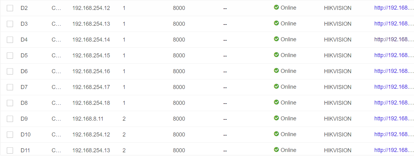

Following your suggestions, I changed the IP addresses on the cameras and they now have an IP in the range of the NVR: 192.168.254.xxx
In order to do so, I unplugged the cameras from the NVR (I temporarily used a standalone PoE switch connected to my router), set their new IP address using the SADP tool (IP in the range of the NVR network and 192.168.254.1 as gateway) and then plugged them back to the PoE ports of the NVR; after that I had to change the camera settings from the NVR, by changing the Adding Method to manual and redefining all the parameters: IP, channel, password, etc.
The result is that I now have the below situation (the screenshot is partial, but I think it represents the situation):

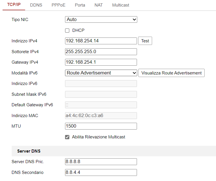

Finally I reviewed all network settings by accessing the cameras admin interface, and the following is the typical settings all cameras now have:
The point is that, even after this change, the cameras still do not notify the VCA alarms via email.
From the camera admin interface, if I configure the email settings and do a test, it won't work. The exact same configuration works instead from the NVR.
It seems to me that the cameras are still isolated and cannot reachout to the Internet via the NVR.

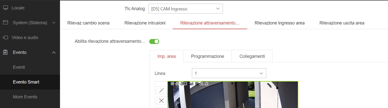

The attached image: View_For_Single-Channel_Camera is the view I see from the browser interface, when I select the single-channel camera. It corresponds to what you described.

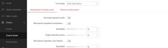

The attached image: View_For_Bi-Spectrum_Camera is the view I see from the browser interface, when I select one of the Bi Spectrum cameras I have. In this case, the VCA configuration for line crossing and intrusion area is totally missing.
Just in order to be sure, I attached a monitor to the NVR, but also from the native interface of the NVR, under: perimeter protection / smart events, the behavior is the same: OK for the single-channel camera, missing for the others.
