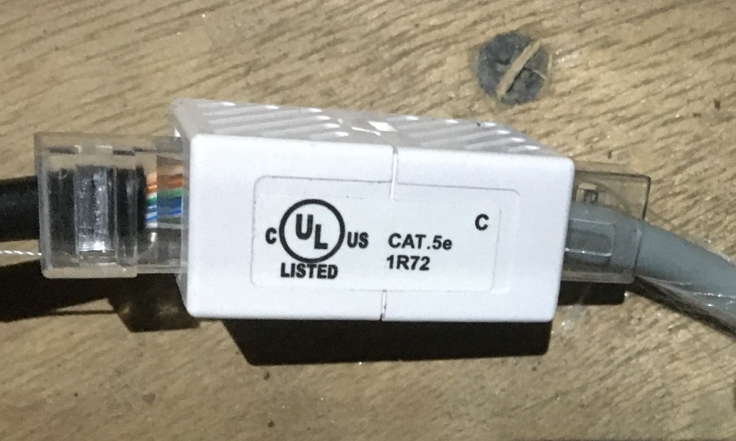

Hello, I am reasonably proficient in mechanical things but I have an annoying problem with a PTZ camera and I need some very basic help if possible please. Firstly, let me say that there is nothing wrong with the camera itself, when I can get it to work it works well. I am convinced that it is a cable problem, or rather a connector on the cable run. We keep losing the camera on the NVR but when I climb up into the attic and play with the connector most times the camera starts to show again. I have attached an image of the connector and in my World I have never come across such a complicated cable. It looks like there are lots of individual wires that go to make up the cables and my thoughts are that if it is reasonably easy to get a new connector and replace the existing one then it will save wasting time of the installers.
I know it will be a very basic question and I really would appreciate being told a, what type of connector it is and b, a pointer on how to use it, i.e. a YouTube video or something lke that. Thanks to anyone who will help.

Wow, that was a quick reply. Thank you very much indeed. Yes, the plugs do come out of the coupler but I thought that maybe there might be something wrong with the actual plugs themselves. In the image the black cable comes from the camera and the grey cable was put in when the builders built our house. I asked them to put such cables in because it meant that they were on the inside rather than the outside. The camera system installers would have put the plugs on the ends of the cables and it looks as if it could be a fiddly job. Is a special tool required for such work ?

Yes, the connectors are known as RJ45 connectors.
You should be able to find lots of How To videos on YouTube.
They are fiddly to get right, if you have the option it is often best to just purchase a factory made patch lead of the necessary length.
The white box is an RJ45 coupler, simply used to join/extend two cables.

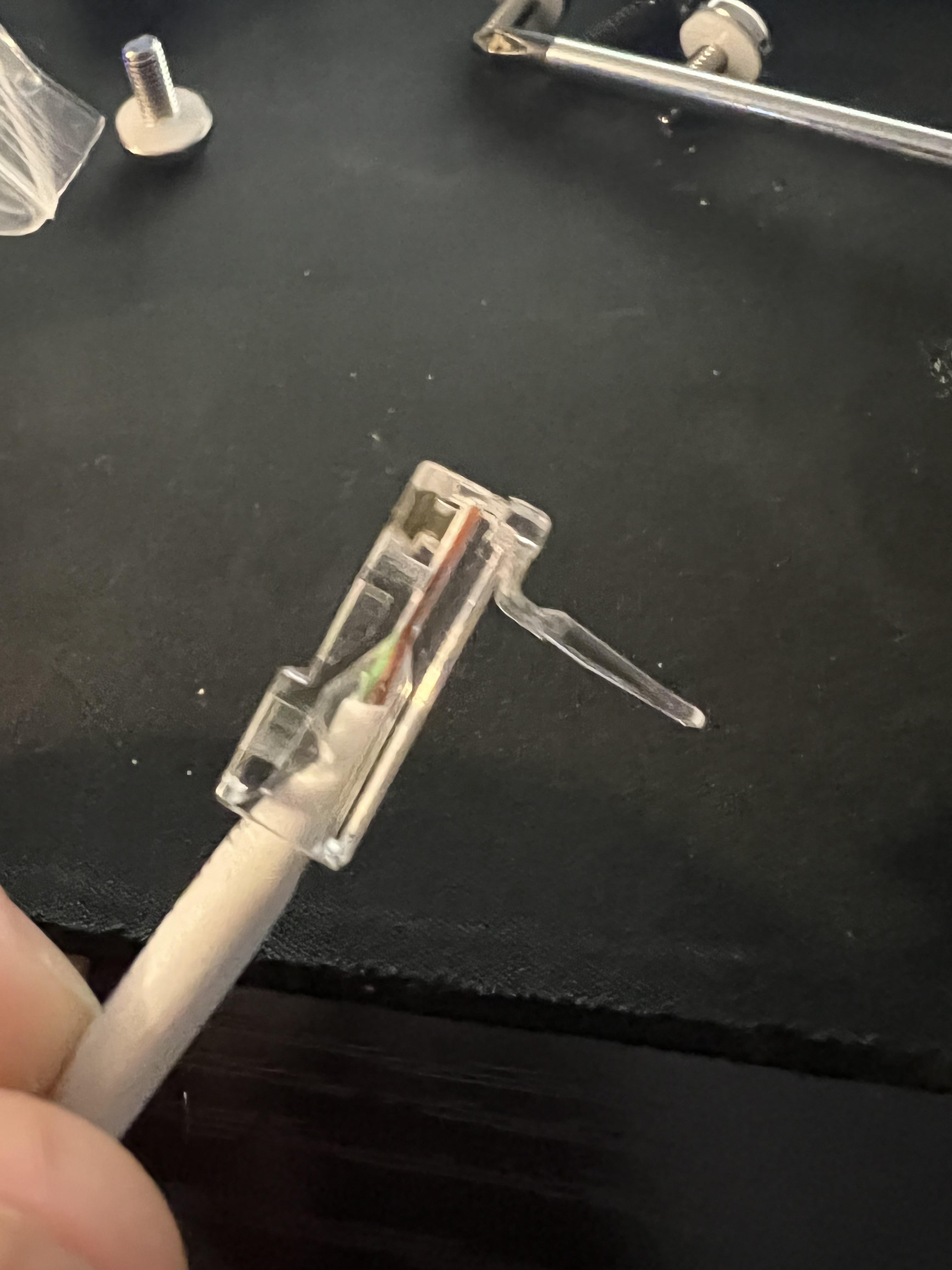

Ok so I very much doubt the RJ-45 connectors will need to be replaced, it would just be the coupler or perhaps try this, sometimes when an installer would crimp the RJ45 connector on the cable they don't bend back the plastic arm on the connector. I usually bend them to a 90 degree angle from the plug (not too much) (see pic below) this will ensure that they stay in the coupler snuggly.
If you actually need to replace the ends you will need to watch a video on how to crimp the RJ45 head.
Problem with this is there are 2 standards A & B whatever standard is on the opposite end needs to be maintained at the other end (normally, unless you are connecting to a switch)
I normally (and most people) use B which is as follows :

if you do need to go down this route, you will need a RJ-45 Crimper, RJ45 Plugs, ideally a tester also.

Apologies for the late reply but thank you very much for that. Today I bought a very cheap cable tester from Toolstation and together with a jack lead I think I have discovered that one of the cable ends that goes into one of the connectors has a faulty plug. Having said that, and as a last resport, I pushed the cable hard as it goes into the plug, put it back in the connector, and I have got the camera back up again !
And I have watched a few videos on YT and I could be persuaded to buy a kit wihich contains some terminals (the "thru" ones seem to be favourite) together with the crimping tool, cable cutters and strippers although I have already got a few of the last two items. Of course Sod's Law has determined that the faulty plug is right up in a loft where you can't stand up, only crawl along some boards that I have fixed onto the joists. But we are getting there and there is no doubt I wouldn't have got anywhere if you guys hadn't been ready to help me.
