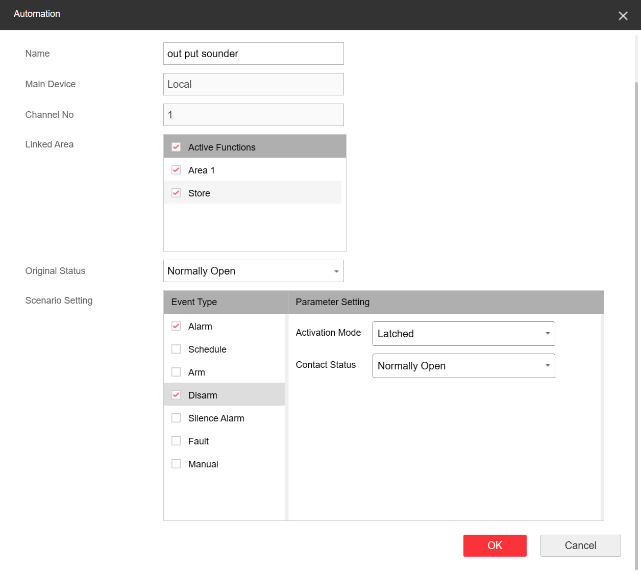

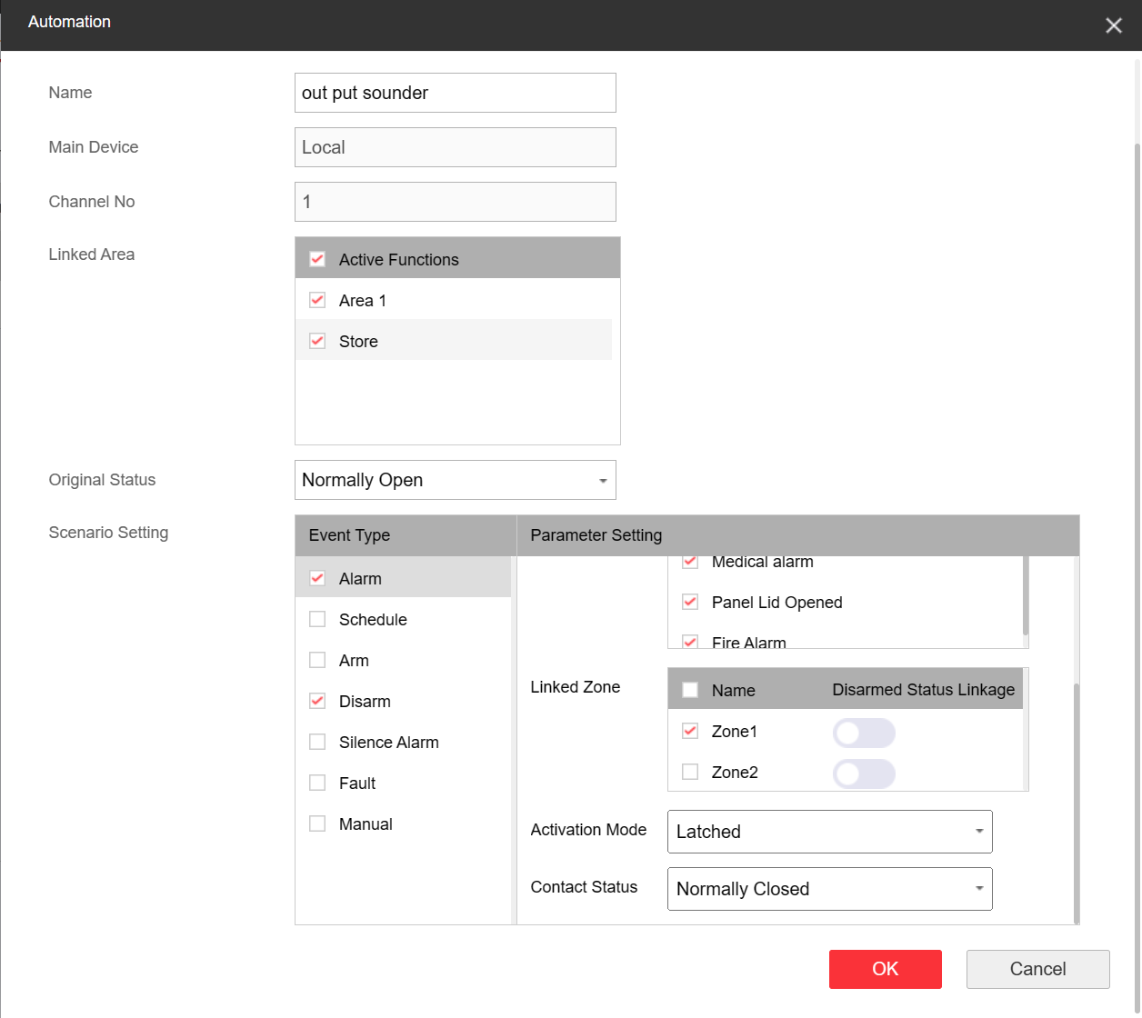

Good Day.. i don't know if it's same with DS-PWA96-M2H-WB .
Link the output(automation contact) to corresponding zones and for events to alarm and DisArm .
Set the the alarm secondary configurations to latch ,
Contact.. to Normaly Close,
set Disarm Secondary configuration to Latch,
Contact .. To Normaly Open,
save configuration
this should work.
thanks
NB: Contact State should be Nomaly Open:
