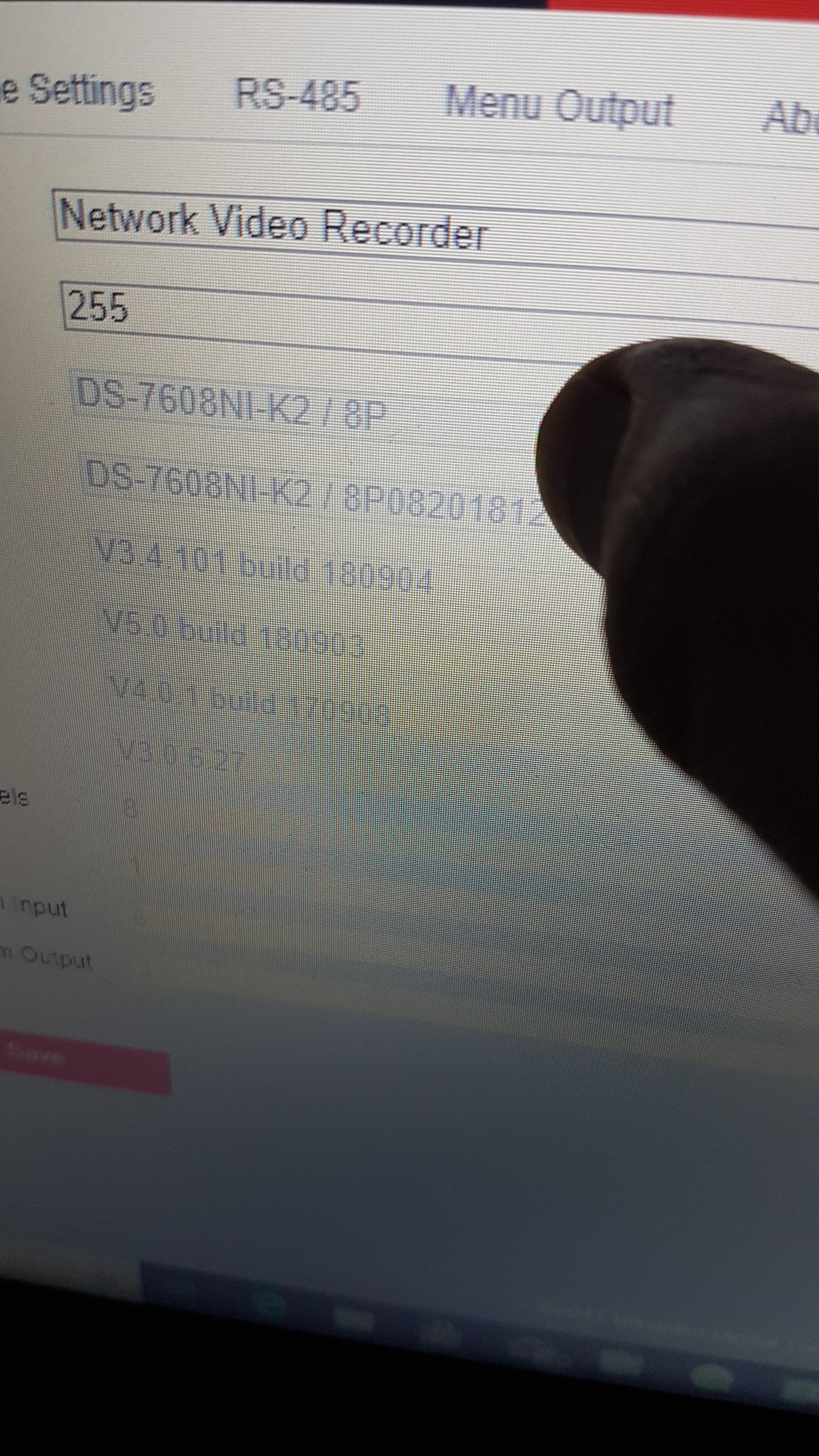

Ok the model is DS-2DE4A225IW-DE
And the firmware is v3.4101 build 180904

If you are going to have it directly connected to the PoE ports of the NVR then you will need to enable Virtual Host to log in to the camera directly and check what firmware the PTZ is on.

Can you enable Virtual host as I describe above and login to the PTZ directly to find out what firmware it is currently on. (If you have activated the camera by directly connecting it to the NVR it will have been activated with the same username & password as the NVR)

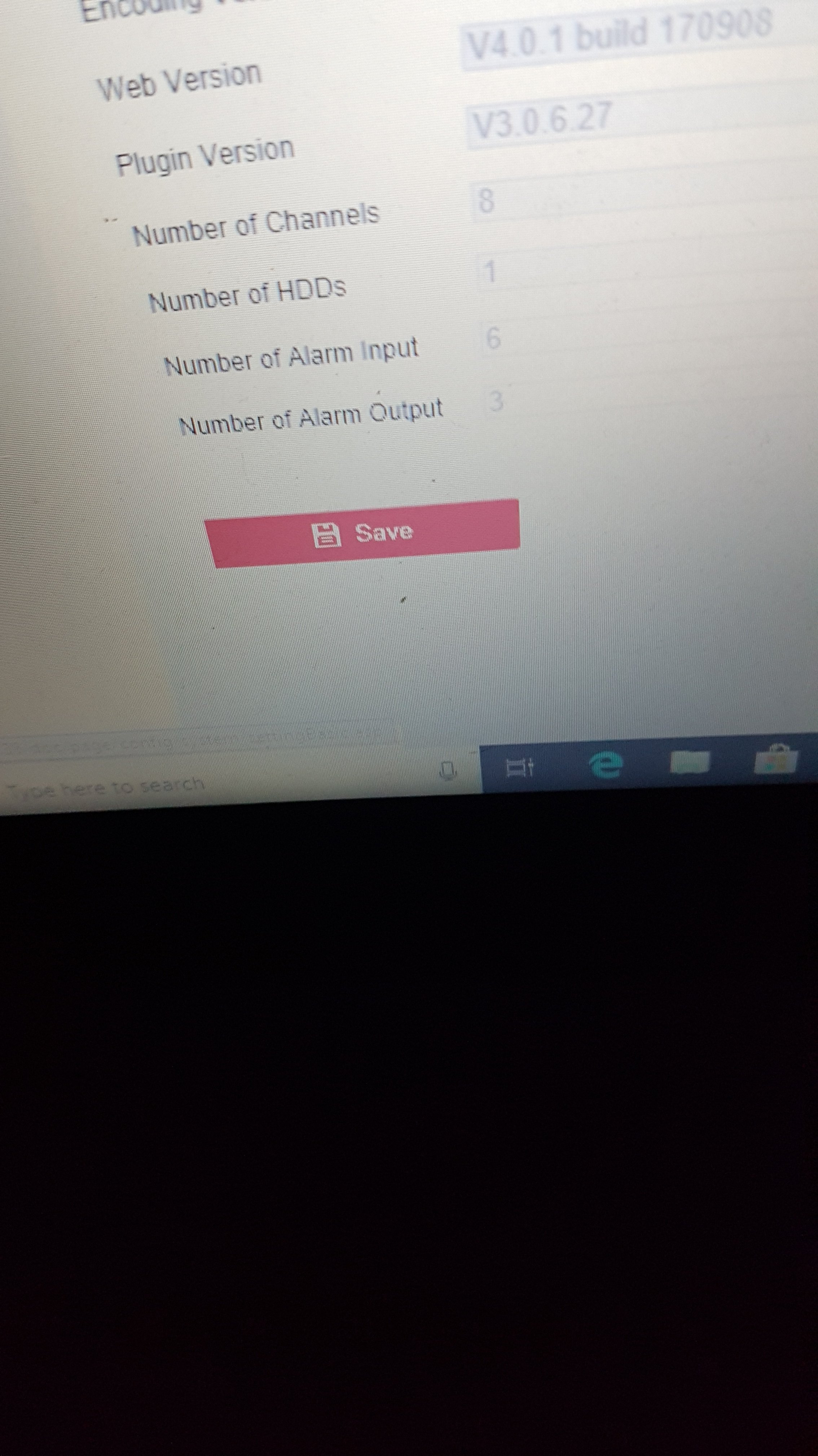

This is one the NVR
Ok, do you know the login details for the Admin user? You should have created the admin password when you first setup/activated the NVR
ok, so have you been able to login to the NVR with the admin username and password, can you please enable Virtual Host and then log in to the PTZ and let us know what firmware version the PTZ is currently on.
