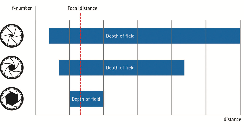

Yes, you would set the target aperture and exposure level. if the scene changes the iris and shutter speed will adjust to avoid under/over exposure from light changes. The camera above has a P-Iris, see below from Axis white paper;
  1. P-Iris is a new type of iris control that is both automatic and precise. Unlike a DC-iris lens, the main task of the P-Iris control is not to continuously adjust the flow of light through the lens. The primary objective of P-Iris is to improve image quality by enabling the optimal iris position to be set so that the central and best-performing part of the lens is used most of the time. This position, expressed as a specific f-number, is where the lens performs optimally, where many optical errors are reduced, and where image quality (with regards to contrast, resolution and depth of field) is at its best. This is the default setting in a net- work camera with P-Iris.
