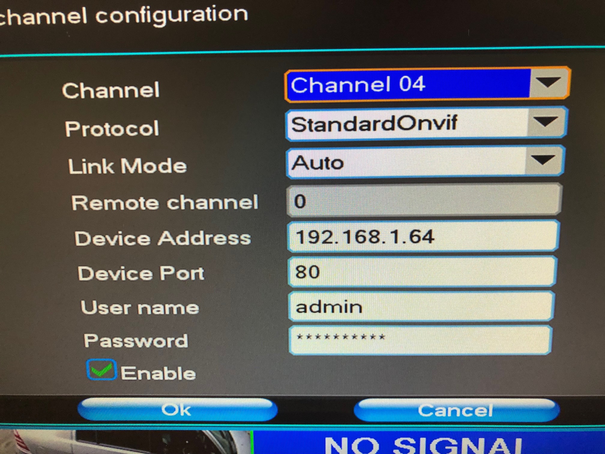

It's going to be a challenge narrowing the issue down this blindly. Would you be able to attach a photo of the camera configuration page from your NVR? The problem could be related to how the NVR is connecting to the camera. Usually a third party camera connects to the NVR via ONVIF. It's possible to see a camera on the NVR but not have the stream recorded if improperly configured. Why the NVR is misreporting the recording is part of the puzzle. Don't upgrade the firmware on the camera. The Chinese grey-market cameras are at risk of bricking. How is IP address of the camera assigned? Did you give it a static IP or did the NVR assign it an IP with DHCP? Having to re-enter a password every 4 days (I'm taking a long shot here) may be related to DHCP lease times. Any additional info and pictures of the NVR camera setup screens would help.
First of all, thank you for taking the time to try and help me. I attach two photos from the NVR screen, and from those you will see it connects via ONVIF. It does have a static ip address. I have just had to re-enter the password again this morning. I have an identical camera (stream no.3) which has absolutely identical settings, and yet works fine and has never done this.

I don’t think the camera is faulty, I’m fairly certain it’s just configured incorrectly. Your grey market camera may just need ONVIF to be properly configured. Looking at your attachments, the NVR is configured to connect to port 80, the camera’s HTTP port. This might explain why you see a preview stream but have no recordings. Ideally your NVR should record the main stream using RTSP via ONVIF.
Try change the camera’s device port to 8000 from 80 on your NVR. This will allow the NVR to connect via the management port on the camera. This will allow the NVR to make changes to the cameras settings. Let me know the result if it produces an error message.

OK, I have now changed the device port to 8000 on the NVR, and I shall have to wait a while to see if it continues recording. As you know, it usually records perfectly for three or four days, then suddenly stops recording. So I shall keep checking it everyday to see how long it goes. I will let you know how I get on.

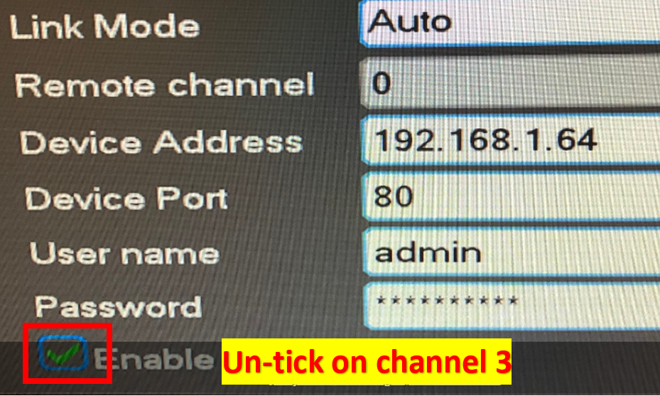

Since it did not improve the situation change the settings back. Just to clarify, you have an identical camera on Channel 03 that is not giving you any hassles? If so, please try disable the working camera on channel three for a day. If the recording improves for the camera on channel 4 it may hint at a limitation on the NVR.

OK, I have disabled the other camera and will now have to wait a few days to see what happens. Crossing my fingers!

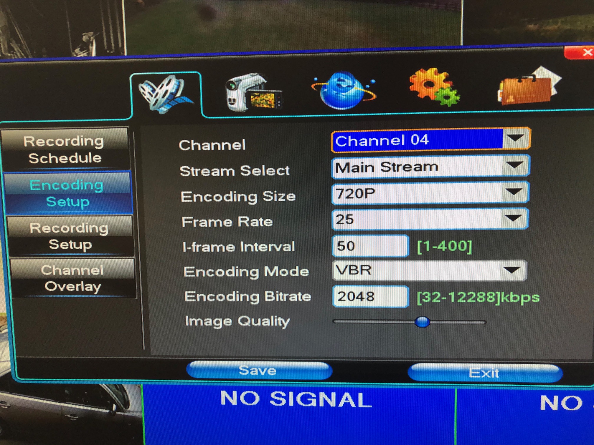

On reviewing the NVR recorded camera footage , it recorded correctly for a few days, and then left a big gap where - when reviewing the footage - it was showing old footage (the attached photo will explain: looking at late morning, all was ok, but then in the afternoon it was showing night-time footage). This is with one of the other PTZs disabled. I regularly check the cameras via my iPad and there didn't appear to be any problem. The PTZ with the problem is about 200 yards from our house (we live on a farm), connected by Cat 5 cable, but with local power at the camera. This problem has occurred on and off, but now is happening very frequently. Perhaps it is time we bought a new NVR?
