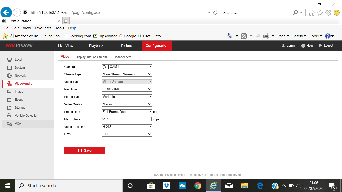

On the camera set up the video stream box is greyed out , so I do not have the option of Video/audio.

see attached.

There are two versions of the DS-2CD2183G0. If you've purchased the Hikvision DS-2CD2183G0-I, as you've mentioned it won't support audio I'm afraid. The Hikvision DS-2CD2183G0-IS however, does. The -S in suffix of Hikvision model numbers means the camera supports two-way audio.
It's worth checking which of the models you have. If you do indeed have the -IS model, then you'll still need to buy and add a separate microphone as they come with capability to support audio but not with an in-built microphone.

Thanks, I listed the correct one, but it seems I have been mislead in my thinking..... A Prefix is at the beginning . A Suffix is at the end.
So my cameras cannot support audio. Any recommendations to one that will ( I need this for evidence of noise nuisance ).
