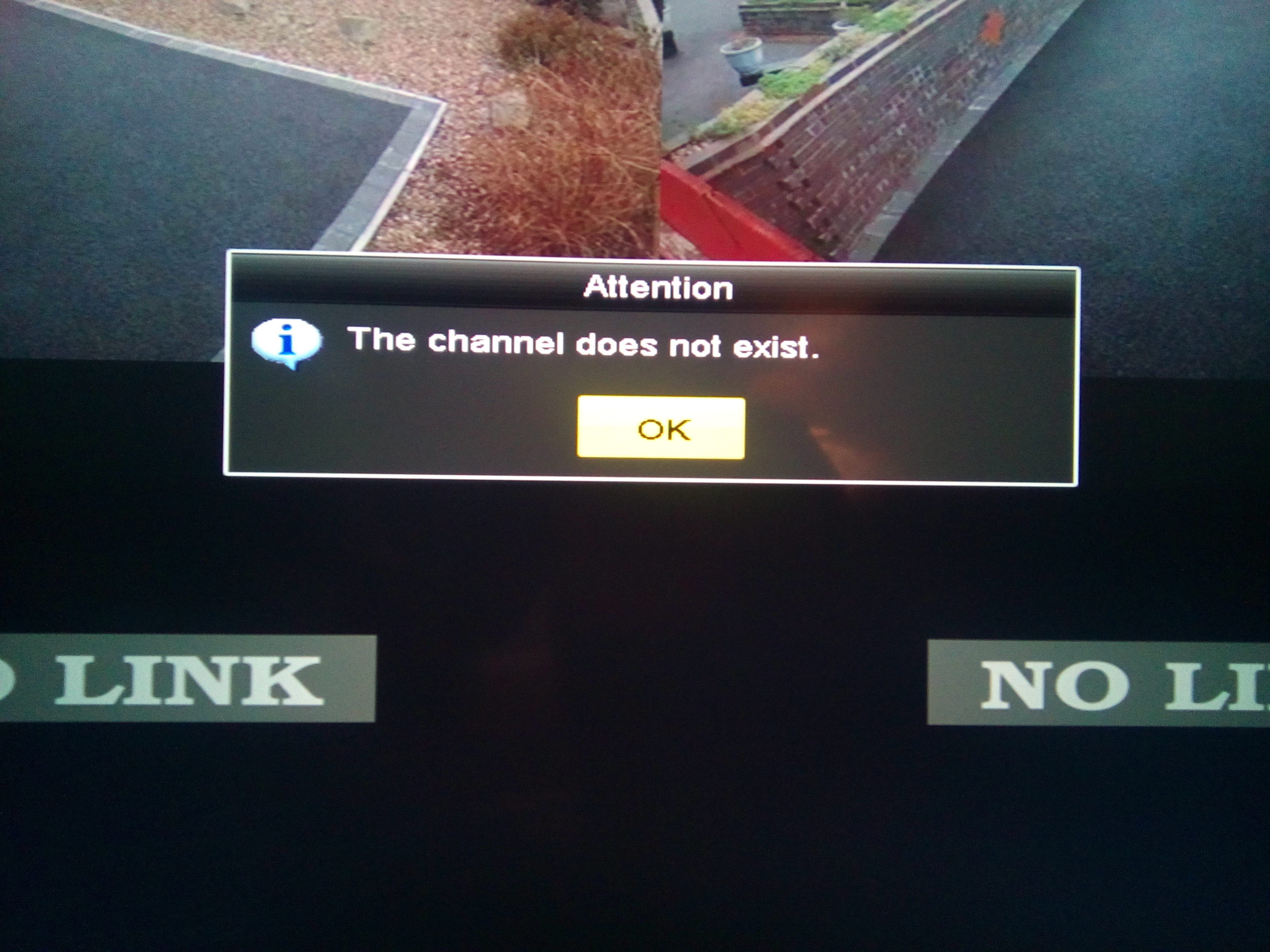

Hi all, my first post so her goes..
I have a Hikvision DS-7600 NVR with two Hikvision DS-2CD2335FWD-1 cameras. The system is about 6 months old and worked great using my 8 year old Samsung LED TV.
I have now replaced the old TV for a new LG 49SK8100PLA HDR Smart 4K Super UHD
I set system up on the new TV, plugged in the TV and NVR, started the TV and then booted the NVR. Great it all worked just like the old Samsung TV. Then I started to get a message on the TV saying ‘Attention. The channel does not exist. OK’. Using the NVR mouse I clicked OK and the message would disappear but would return, not immediately but after a while.
When I turn the TV off and back on I get a message on the TV saying No Signal. If I go into the Device Connector it says the NVR is connected to HDMI no signal. I have tried all 4 HDMI ports, new HDMI cable but always the same problem. The only way to get the signal back is to turn the NVR power off and back on. Not good practice I know but its the only way to get the signal back to see the CCTV on screen.
Any help would be gratefully appreciated.

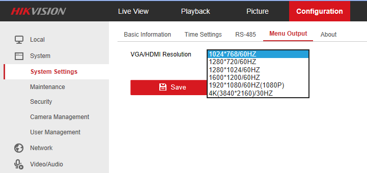

What do you have the HDMI output configured at please?
Does it make any difference if you try a different out put resolution for the connection to your 4K TV?
(I'd expect the TV to be happy with one or other of the last two settings in the dropdown)
[After changing, it may also be worth trying different HDMI inputs on your TV again if problems persist]

Regarding what the VGA/HDMI resolution is set on I cannot find it in the NVR I presume your image is taken off a PC and not the actual NVR itself

I have an older LG TV with a Hikvision NVR and have discovered the "Channel does not exist" issue is the NVR picking up signals from the TV IR remote. I haven't spent a lot of time trying to figure out which keys cause the problem but I think that TV remote issues something the NVR picks up as me trying to go to "channel 99" (or whatever) which doesn't exist on the NVR and throws that error. Clicking the OK button on the NVR remote control makes that dialog box go away and all is usually well after that.
The "input" button on the TV remote, to switch to the NVR input, definitely causes the NVR to change channels, but usually just one channel at a time forward.
I've had the signal go missing as well, but it hasn't happened very often, maybe 4 or 5 times. Unplugging the NVR for a forced reboot was the only way to get it back, but a couple of times it's come back on it's own without needing to reboot. That one I'd like to figure out as well but hasn't happened enough for it to be too big of a deal for me.
