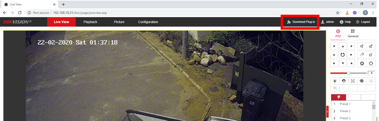

Dan and Kyle Mc - what has your experience been like using the 'Local Service Components' plugin and Chrome?
The G1 series as of firmware v5.6.3 seems fully functionality with Chrome v80.0.3987.116. This wasn't the case with v5.6.0 as I often had issues when trying to load new firmware via the webGUI.
Seems the newer firmware has broken away from NPAPI and works well with modern web standards. Chrome does not register it as a plugin or a extension as far as I can tell so future updates should not break functionality. Fingers crossed.
Hi @StewartM
It's good to hear you are seeing improvement with the browser access from current browsers like Chrome and Firefox, I personally am still seeing some issues as I spend most of my time on a Mac and when you try and download the 'local service components' in Chrome on a Mac is still downloads as .exe file which cannot be installed on a Mac and Hikvision have been very slow to make a Mac-compatible version of the component.
I have just updated an older G1 model (2055 Mini Bullet) to v5.6.3 and accessed from Chrome on a PC and it would appear that all the functionality available when accessing via Internet Explorer are now accessible in Chrome and other browsers. I think when we last spoke to Hikvision support about this issue, which was way before v5.6.3, they had said that they were still having some issues with higher megapixel streams (8 &12MP) not working and that H.265+ was being problematic. I don't know what model you have been testing but I have yet to test an 8MP or H.265+ camera that is running this firmware, please keep us updated with any new progress you make and any issues you spot when accessing with Chrome.
