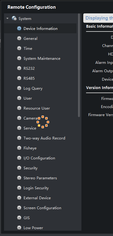

When I try to view the advanced settings for a camera, it shows all the settings in the menu when loading:

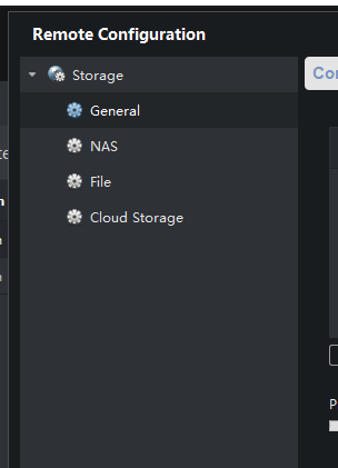

But once it's loaded it only shows me the storage setting for some reason?
Any idea why that is?

i have the identical issue. I can select advanced and watch it load but it finally stops on storage and i cannot access anything else. I am connected directly to the camera, no nvr
There isn't anything else besides that. All the "Advanced" stuff is in "Basic" which opens camera web interface(mindblown ha?). It is commonly wrongly interpreted.

Yea but this is not Camera per se. If anyone would like entire old configuration menu using "Advanced" option, then i would rather suggest using BatchConfiguration tool.
Difference between Basic and Advanced is not in its name.
Basic opens configuration via HTTP using ISAPI endpoints on device.
Advanced opens configurations via Device port 8000 utilizing SDK.
You are right some options weren't rewritten from SDK to ISAPI, but that changed with hardware revisions, as they stopped firmware releases for EOL devices.

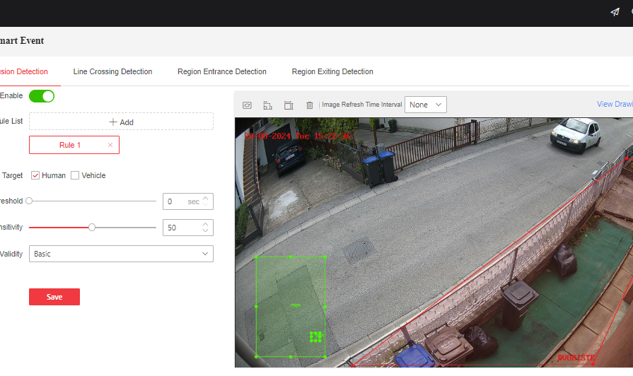

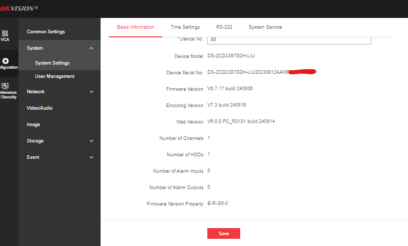

Here is screenshot of my G5 Camera, what is not here that you saw on NVR?
Check your NVR web or iVMS settings VCA- Abnormal Event Detection.
Min/Max values do not calibrate anything. Your preferences in settings are not calibration
