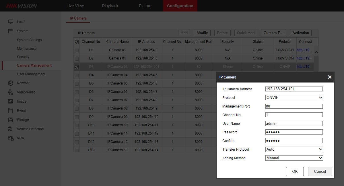

- Navigate to Configuration -> Camera Management.
- Select the row in the camera list for your newly added camera. Initially you are likely to see a password error message.
- Click Modify. Change the 'Adding Method' from 'Plug-and-Play' to 'Manual'. Type-in the camera's password (twice) - which we set in an earlier step to be the same as your NVR's password. Click OK.

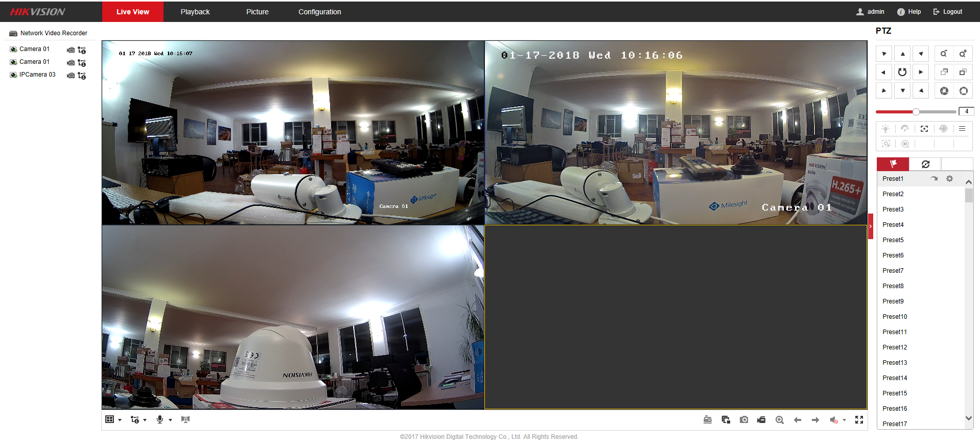

- The NVR should now connect to the camera via ONVIF and you should be able to see a live stream from the camera in the NVR's Live View.
