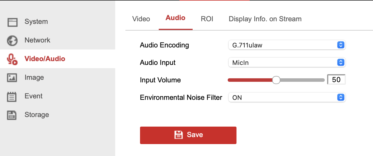

Since purchase I was unable to get the 2 way audio working on a DS-2CD2346G2-ISU/SL and DS-2CD2386G2-ISU/SL model. Selecting the microphone and then selecting IP camera as the Audio destination would either result in an error code being displayed OR if the connection worked, I'd just get stuttering, garbled output from the cameras speaker. I'd been waiting for an update to the the G3 firmware that they use to resolve the issues I assumed it was the camera at fault. They are both connected via the PoE ports of a DS-7616NI-I2/16P NVR. While browsing the Hikvision portal I noticed a newer build of the 4.40.016 NVR firmware detailed - "I series NVR firmware with two way audio failed issue on Hik-Connect for Acusense camera".
I loaded this firmware last night and after testing this morning can confirm that the issue is fixed and the 2 way audio works perfectly now to both cameras when connecting using the Hik Connect app. A link to the firmware is below for anyone else having the issue:
