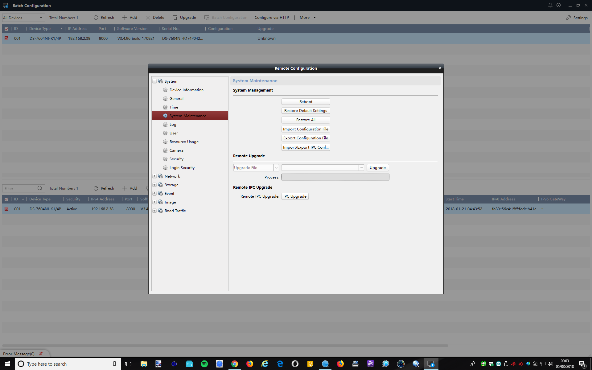

Will the Batch Config Tool let you access and reset them?
Or maybe even edit the Config and fix the problem withour resetting them?
The Batch Config Tool can be downloaded here:
DOWNLOAD PORTAL
I gave it a go but it only allows me to modify the IP address details for the camera but will not add the camera to the top list where you can go further with the config. NVR went in fine.
