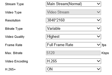

Hi there,
Just wondering if anyone knows the issue I'm facing. I've gotten a hold of the following: DS-7608NI-K2/8P NVR and DS-2CD2185FWD-I 8MP Dome cameras.
I'm just working through the settings, and it seems that the max fps I can set is either 12 or full frame rate.
What frame rate is full frame rate, and why can't I set it to something such as 20fps. I'm using 265+ so I wanted to make use of a higher fps to take advantage of the storage reduction.
The sub stream setting allows me to set the FPS to the max (25+)
Here are my current settings (frame rate only shows up until 12 or full frame rate):
Hi there,

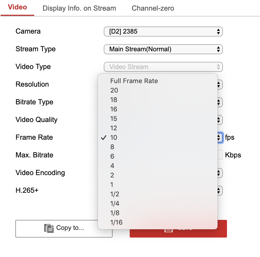

This is not an issue we have seen before, we don't have 2185 as part of our system but the 2385 we have set up is from the same family, has the same Max fps, and uses the same firmware but as you will from the below screenshot we get all the frame rate options up to 20fps.
Is your 2185 running the latest G1 firmware? v5.6.3

Thanks for the reply, yeah the direct settings yesterday allowed me to see 12.5 fps as the maximum. NVR only shows 12 or max frame rate
