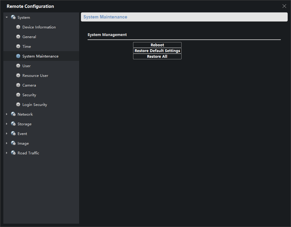

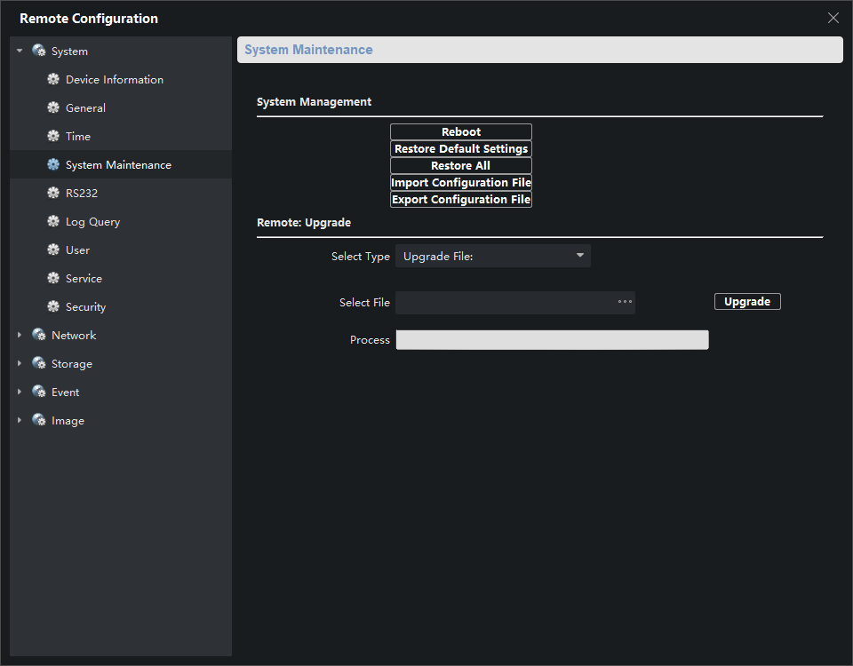

I used iVMS-420 to update the cameras (Remote Configuration > System Maintenance > Remote: Upgrade)
However for the NVR, the Remote: Upgrade option is missing on the screen.
(attached screenshots show the System Maintenance screen for one of the cameras vs the NVR)
I still manage to update the NVR via Hik-ProConnect (by registering as an installer).

Also, do you have any idea why I don't see the Remote: Upgrade option in iVMS4200 (as shown in my screenshots)?
(is it supposed to be there, is it a firmware specific 'feature'?)
Hikvision stated that firmware versions dated earlier than 210628 (28/06/21) are vulnerable, but not all models included the feature that was vulnerable and so even if their versions pre-date this they are not vulnerable. As your models haven't received new firmware since 2018/2019 they likely did not require the patch firmware as they never had this new vulnerability.
No sure why you can't see the upgrade menu for the NVR, we've checked a 7604 on our network in iVMS-4200 on Mac and we could see the option under System Maintenance. What version of iVMS-4200 do you have installed?
I installed the latest version on my PC, this is iVMS-4200 v3.7.0.5 (20211228).
I managed to upgrade the firmware via Hik ProConnect with the web interface, as the Remote Upgrade section is missing in iVMS-4200.
Ok, it may be that this feature has been broken in the latest version of iVMS-4200 for these older NVR models, we have seen issues with old camera/NVR models in the past when Hikvision have introduced new software/firmware because they primarily focus their attention on making sure the updates work for the latest/current models.
If you wanted to try there are some older version of iVMS-4200 available from the UK Download Portal, but if everything else is working ok in the current version I don't think it is worth it as there is unlikely to be anymore firmware released for the NVR model you have.
