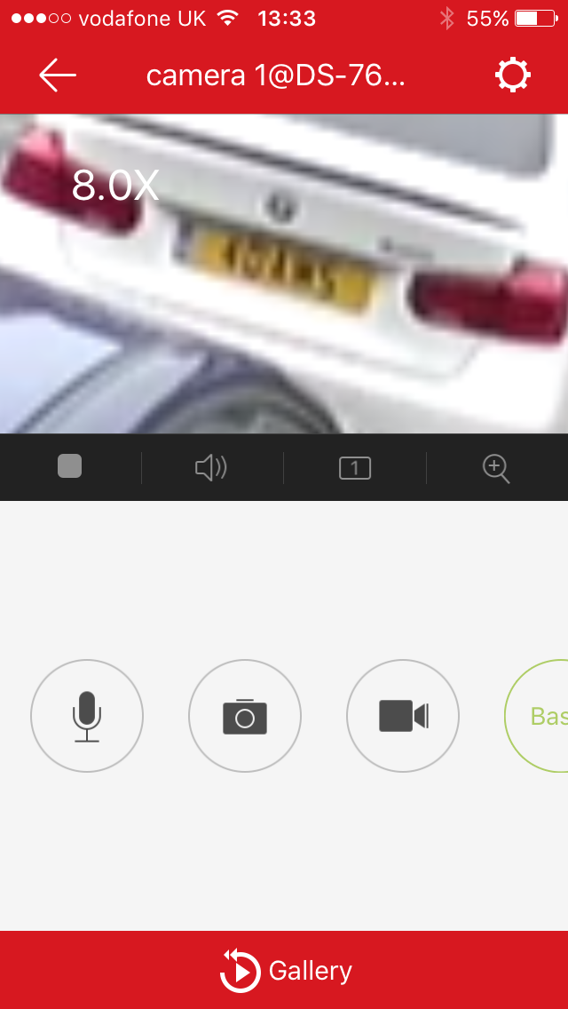

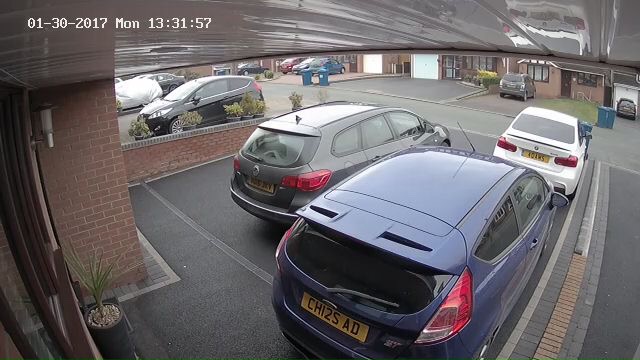

why is my picture so bad?
Yes it's wide field probably 4mm but it can't distinguish a car number plate 15ft away! I can take picture with my iPhone from same location and clearly read Reg of number plate from house opposite 70ft away!
Some more detail , adjusting bit rate upwards of 1023 shows no discernable increase in sharpness. And throughly put varies between 4kbps and 10kbps even on 16kbps setting . I would say camera is focussed well it purely seems as if the camera is not 4-5mp !
Also note that output to tv via rgb is measurably better than hdmi! Why is that ?

Would you be able to upload a full-size capture of the camera's live view? I don't mean a screencap from a phone, but a Hikvision NVR or camera will allow you to take a capture when viewing the camera via a web browser on a PC or software on a PC. I want to check the resolution of the actual captured image.
Alternatively, double-check the camera's resolution setting in the configuration options, again accessible via a web browser.
What you're showing doesn't seem to out of place for a wide-angled 4MP camera - it looks to be a 2.8mm lens.

To keep that wide angle be able to zoom post capture and distinguish a number plate at the road would need 12mp ?
You can access the system via a web browser by entering its IP address into the browser address bar. That'll take you to a Hikvision login page (enter your device's credentials) and then you'll be able to view any cameras in a browser. From here, you can capture a snapshot - double check the camera's resolution in the configuration options whilst you're at it.
With a wide angle, you'll need a high resolution in order to capture something so small at that distance in a reasonable quality.

Thanks all, I did manage to remote in and video is high bitrate and full hd. Pictures were quite big pixel wise circa 500k file size ?
Will just have to go up mpixel to get what I want. Seems the 12mp are generally indoor cams! ?
