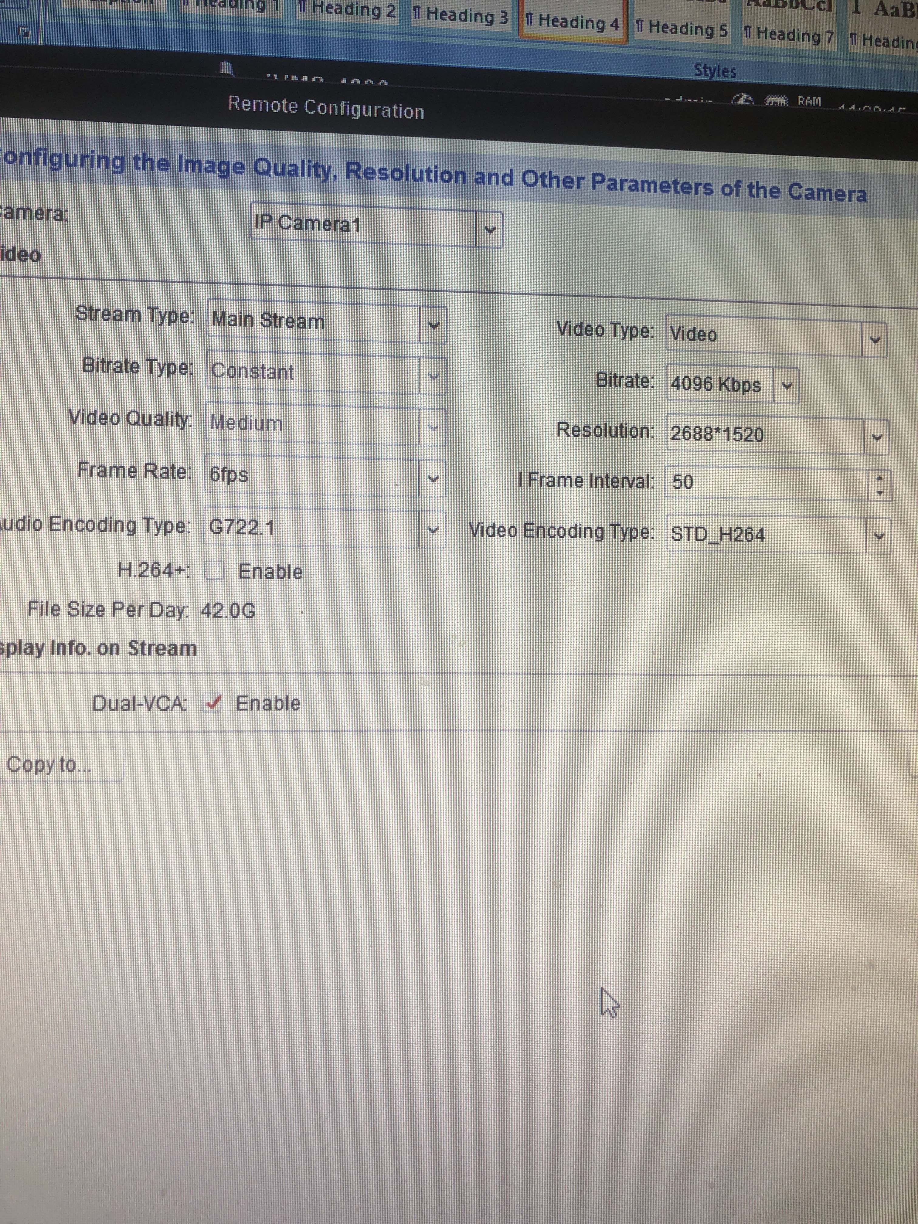

Please upload a screenshot of the settings you are concerned about
Thanks Phil, see attached. I can’t het higher than 4096 on Any camera regardless of resolution etc without locking up and freezing etc
Change to variable bit rate, High quality and set your cameras to use the h.265+ CODEC

Some cables are home made. The latest ones to the new 8MP were bought though. It seems odd that on a NVR with 160mb in and out I can’t achieve the max bitrate. I may try the H.264/5+ again and see how it goes.
