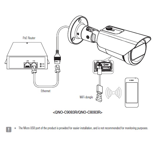

I attached what the manual says.
Hi @JohanD
Unfortunately, I think you might have been confused by Hanwha's description of this WiFi feature.
If you look at the text in the screenshot you attached you'll see that the WiFi dongle connection is only for installation and links to a specific Wisenet Installation App.
It is not possible to permanently connect to the camera using this WiFi dongle, a hard-wired connection is required to be able to access the camera with a browser and add it to an NVR or VMS.
