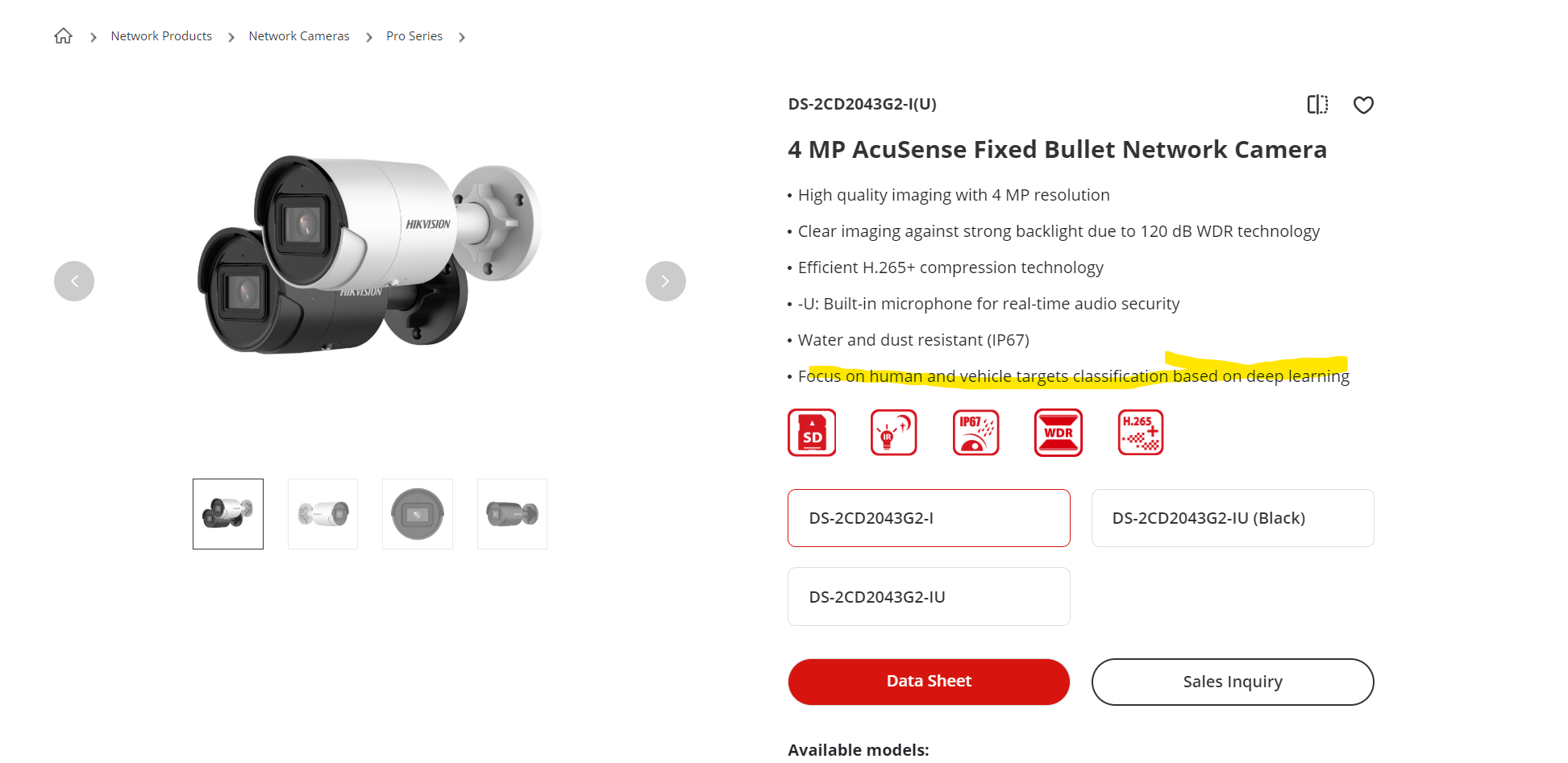

What about this text 'Focus on human and vehicle targets classification based on deep learning' in DS-2CD2043G2-I, does this mean it supports it?
Upvote 0
That's just what all AcuSense cameras do - make a decision as to whether something is Human, Vehicle or not. In the event setup applying a filter such as 'Human' is supposed to ensure that only motion detection or line crossing events occur if a human triggers them. Information for age, sex, clothing colour isn't given by the camera.

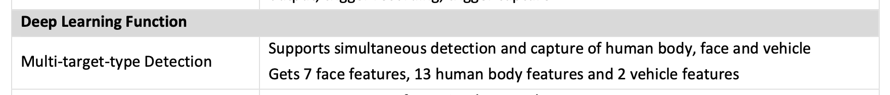

Look at this camera to see the difference - IDS-2CD7A46G0-IZHS
