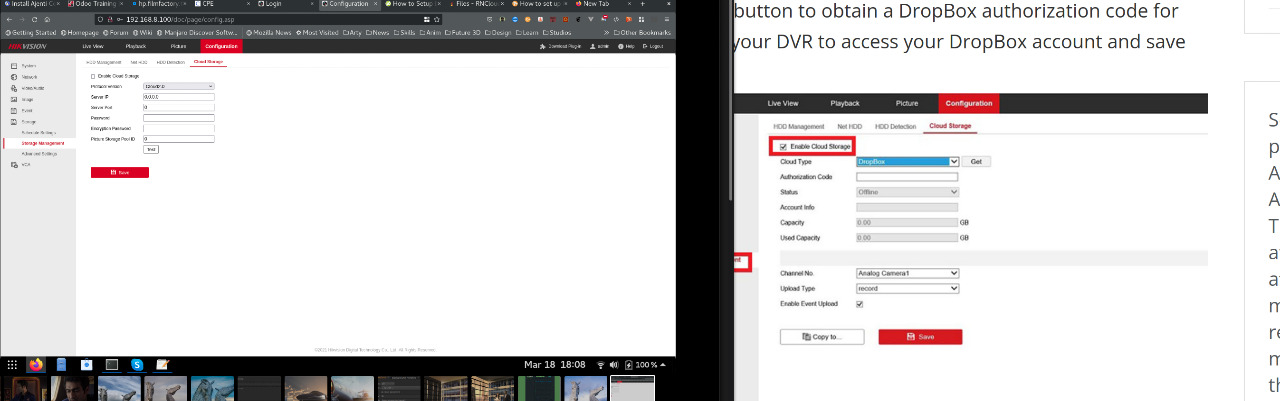

My intention was to take an image after interval ( 1 min ) and upload to dropbox. when i see documentation, my settings are different. Just wanted to know reason.? i can only see cloud1 and cloud 2. all docs and videos on youtube (in last year) shows dropbox option etc.

Hi @lalamax3d
In regards to the first question, have you tried logging into the NVR with Internet Explorer? The older software on the K-series NVRs is not fully supported by modern browsers like Firefox or Chrome and so some features/menus can be missing when accessed with these browsers.
