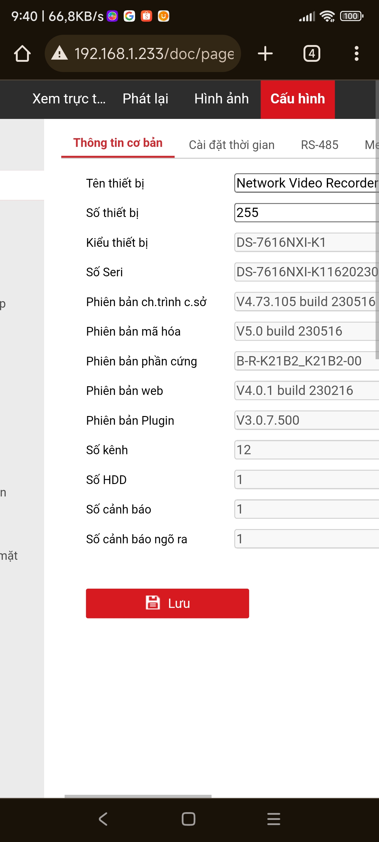

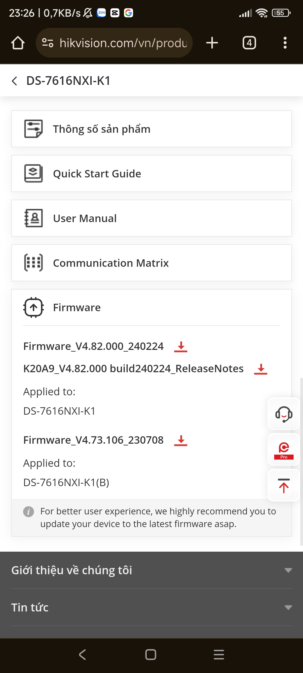

I just bought a Hikvision camera for 150 USD that has night color function and distinguishes people and vehicles, but it does not have line crossing. I have to spend another 150 USB to replace my current NVR with NVR 7616nxi-k1. When I look at the firmware, it looks like the photo below. If Ver B is newer, why is there an older firmware? Ver doesn't have B and my current recorder doesn't have max size and min size when setting smart event, so disappointing.

Looking at your images, the Hikvision website, and the Hikvision firmware download portal it looks like this is a rare case where the non-(B) model is newer/more current than the (B) model.
Your screenshots above show the firmware family for your NVR model is B-R-K21B2, when I looked in the Hikvision EU download portal I saw that only the K-series (B) models use this specific firmware and I could only find this specific firmware on the EU download portal which suggest the (B) models are region-specific and only the non-(B) models are available elsewhere.
This unique firmware for the (B) models might also explain why they are missing certain settings available on the non-(B) models.

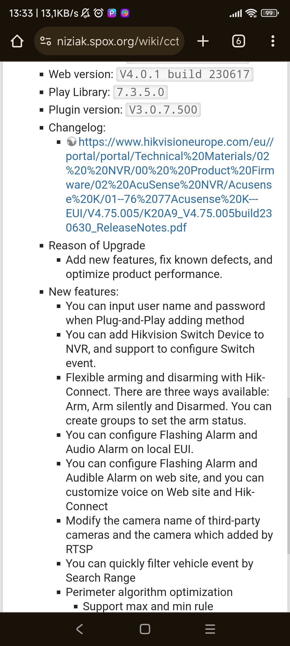

can i wait for an update for min max size function? :((
The latest firmware for the (B) model you have is from July 2023 so that makes me feel like they don't have any plans to release new feature updates for this particular model, but Hikvision are very unpredictable so they could just drop an update for this model out of the blue.
