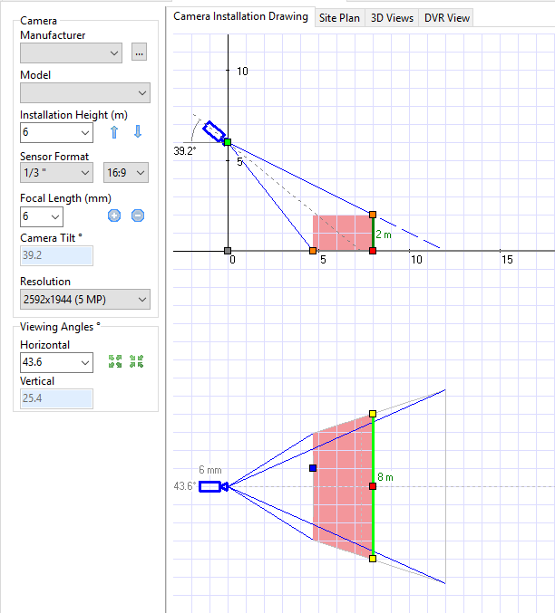

I am going to mount the cameras higher on the corner of the house under the eaves if I bought 6mm lens versions of the domes do you think it would give me a decent enough shot of the other side of the house 8m away?
Let's say you select a camera model where a 6mm lens gives you a typical 50° horizontal field of view. Then at 8m distance, the scene width you will see will be approximately 8m.
You might like to have a play around with the camera planner provided by IPVM to layout cameras around your home:
