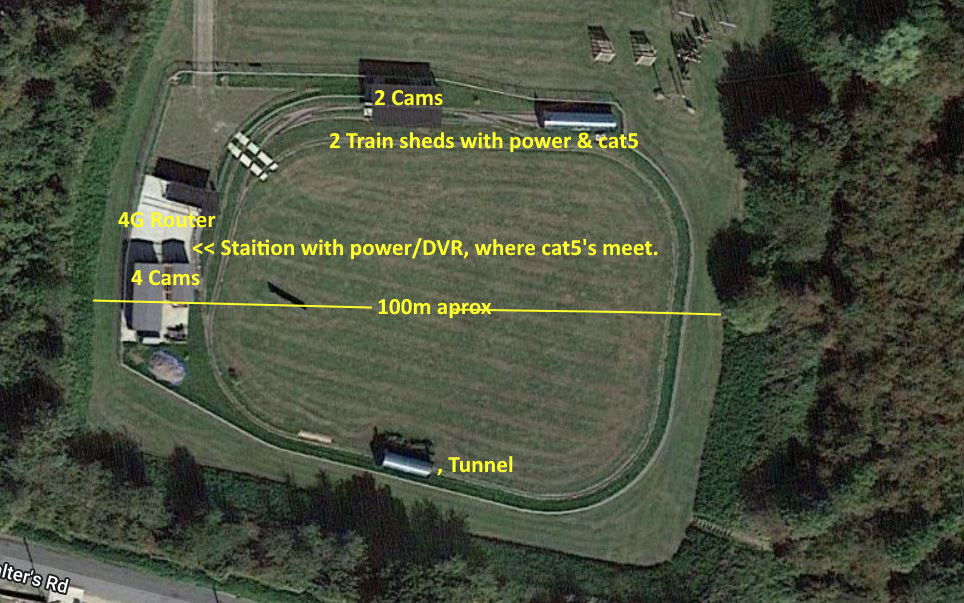

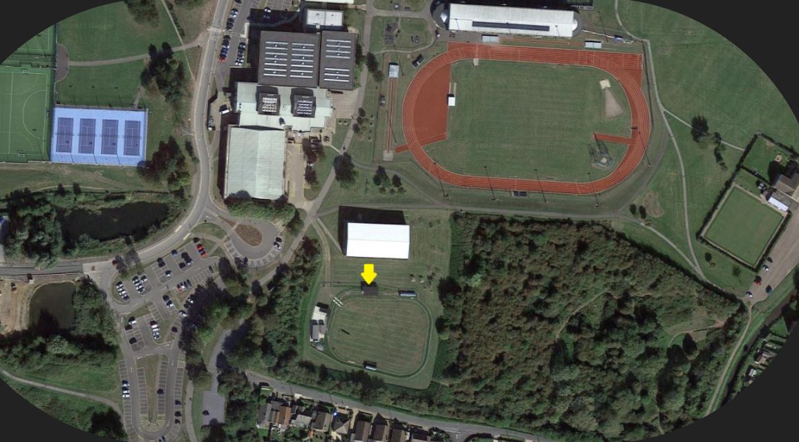

Hi, the only building that belong to the club is the ones around the track as seen with yellow arrow & two more to the left of arrow & down. The big white roof & any others are nothing to do with us.
Can you mark on the photo specifically where is your building and where is the location of the cameras and power supply ? Can’t really work out from what you’ve said there.
Mark it with A for your building and B for the location of the power and NVR.
I’m not worried about what doesn’t belong to you - I just want to know where is A and where is B
Not sure why you want this info ??? There is power in both buildings & cat5 cables between all. The cctv & DVR is the simple part. My question was on the price of using a sim for data for remote viewing. I believe i can set the DVR up to only send/upload video when somthing is detected & not a 24/7 stream of video data. So this should help keep the MB down.
I'm trying to work out if a wireless bridge would solve your problem - as you'd not need a 4g/5g router at all then.
If your NVR was at the yellow arrow - but your own building with the broadband connection was at A B or C for example - you could use a wireless bridge rather than a 4G router. They can work over quite a distance.
Based on your photo above then yes you could use a wireless bridge - the cost of the parts would be likely less than £200 and you’d use your existing network and there would be no ongoing charges. You’d run a network cable to a receiver/transmitter from your existing router at one end - and then have a receiver/transmitter at the other end. They would point towards each other (and there’s an app to help line up the best signal). You’d then have a router at the other end to plug your cameras into - if they are POE cameras you might also need a powered POE switch (you can also have wifi in your building as well).

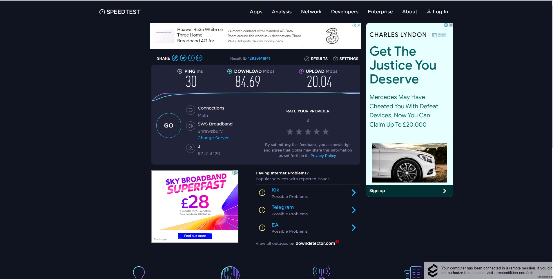

Then definitely look at the Three coverage in your area - this is the speedtest I've just run on a remote PC at a church at the top of a mountain, which realistically isn't actually that near any mobile towers, but due to its height I think we've been lucky to get a decent connection. These speeds give us unlimited data for £24 a month (5G). As well as having our Hikvision NVR connected - there's the above PC that I can connect to remotely that livestreams church services, and the dropped frame rate on OBS is under 0.1 percent from an hours transmission. (Which is pretty good if you're not a live-streamer). We haven't lost communication once since installation. There was a day where upload speeds were low due to maintenance on the network, but the connection remained.
