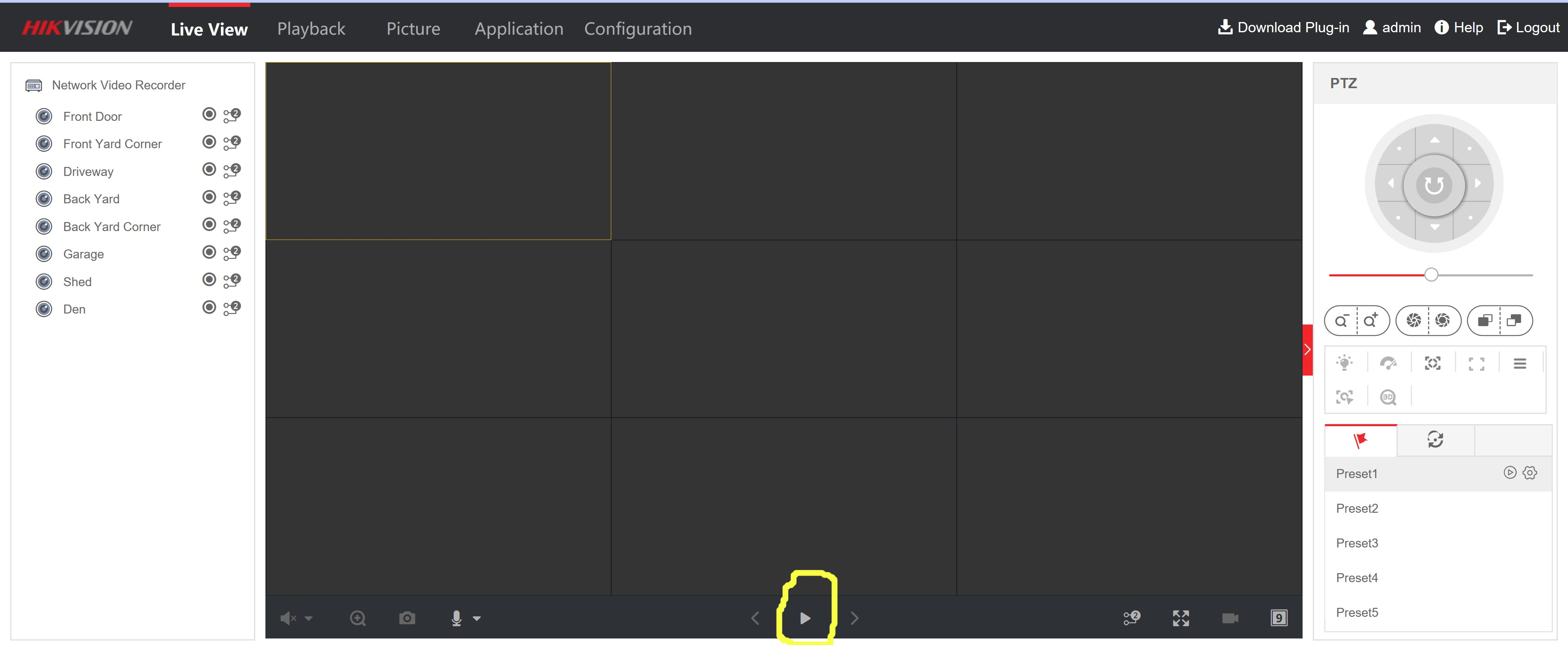

Spark - not sure what your current problem is. But once you log in and see the boxes that should be displaying the video feeds, hit the "play" button at the bottom center. The older firmware versions would just start the video feeds automatically. Now you have to hit "play" in order for them to start.

Ok...I had to upgrade the firmware to all my cameras ...done...I can also get onto the NVR from my browser but I still dont see any live views or recordings.

Use Edge with the Internet Explorer extension. Make sure you "engage" viewing the sign in page with the I.E. extension, then sign in. Then hit the play button as shown above.
