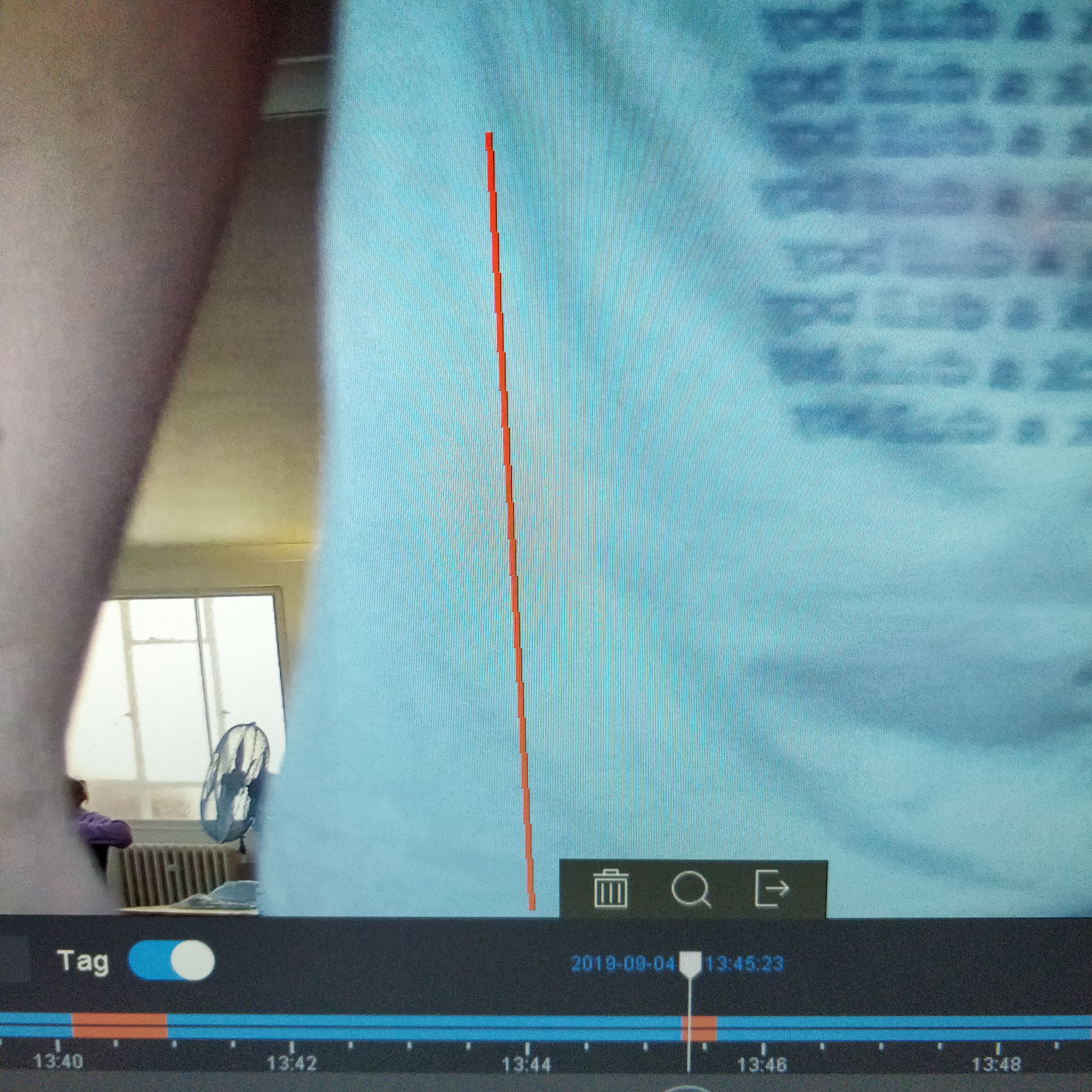

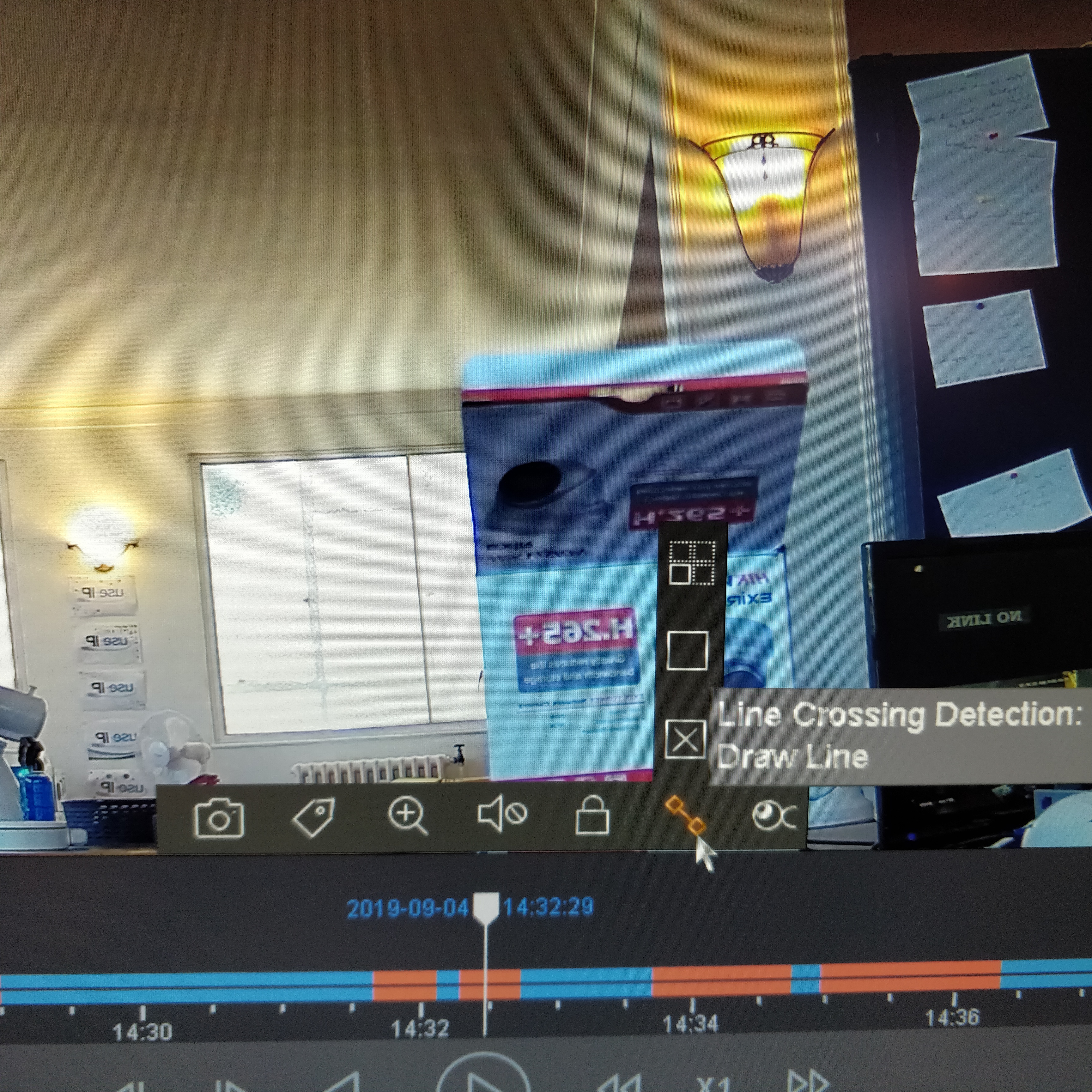

Smart Playback - Smart Playback has 2 key playback functions, the first is to allow you to navigate through the smart events you have enabled in the Events menu with them displaying as red markers over the top of your continuous recording. The second feature is the smart ability to scan all your recorded footage for either motion/line crossing/intrusion detection whether or not you have any of those events enabled on those cameras. So, for example, you can hover over the playback image and select line crossing (see below), draw a line on the playback image, click the search button (magnifying glass), and the event markers in the playback will change to show you any person or object that has passed that line you have drawn on the footage. Now, because this smart setting is happening on NVR side instead of inside the camera the accuracy of it is not 100% but it can be a useful feature if you need to find something on a camera that doesn't have events set, has events set but in a different part of the scene, or cannot have events set at all. (footnote to this comment, we did try this feature with some ONVIF cameras connect to our Hikvision NVR and it didn't work so it is a feature exclusive to Hik cameras)

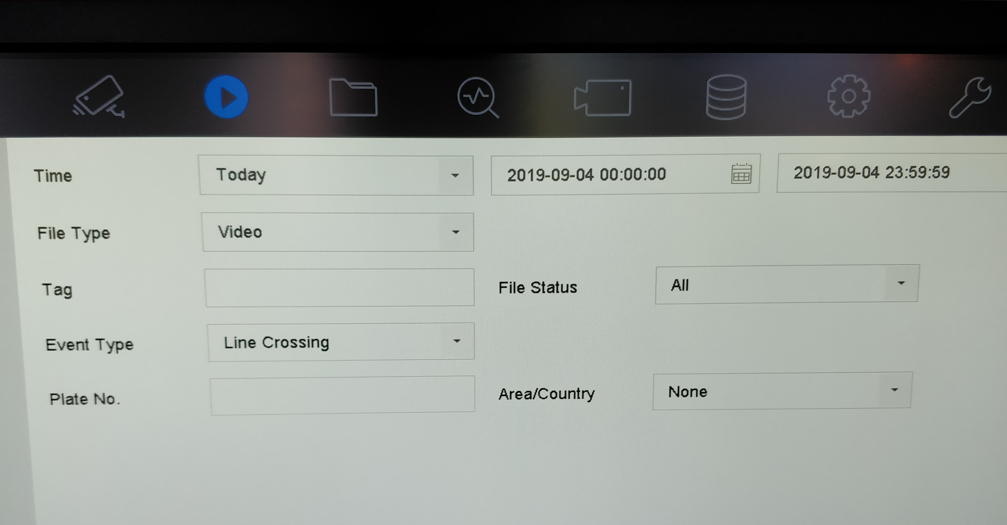

Custom Playback - If you click "Custom Search" in the bottom left of the playback window you will open a window that allows you to search by the specific basic/smart events you have enabled (see below), this is useful in situations where you have cameras running multiple events because you can search for one specific type of event and only see those ones rather than seeing all the event markers as you do in Normal Playback.

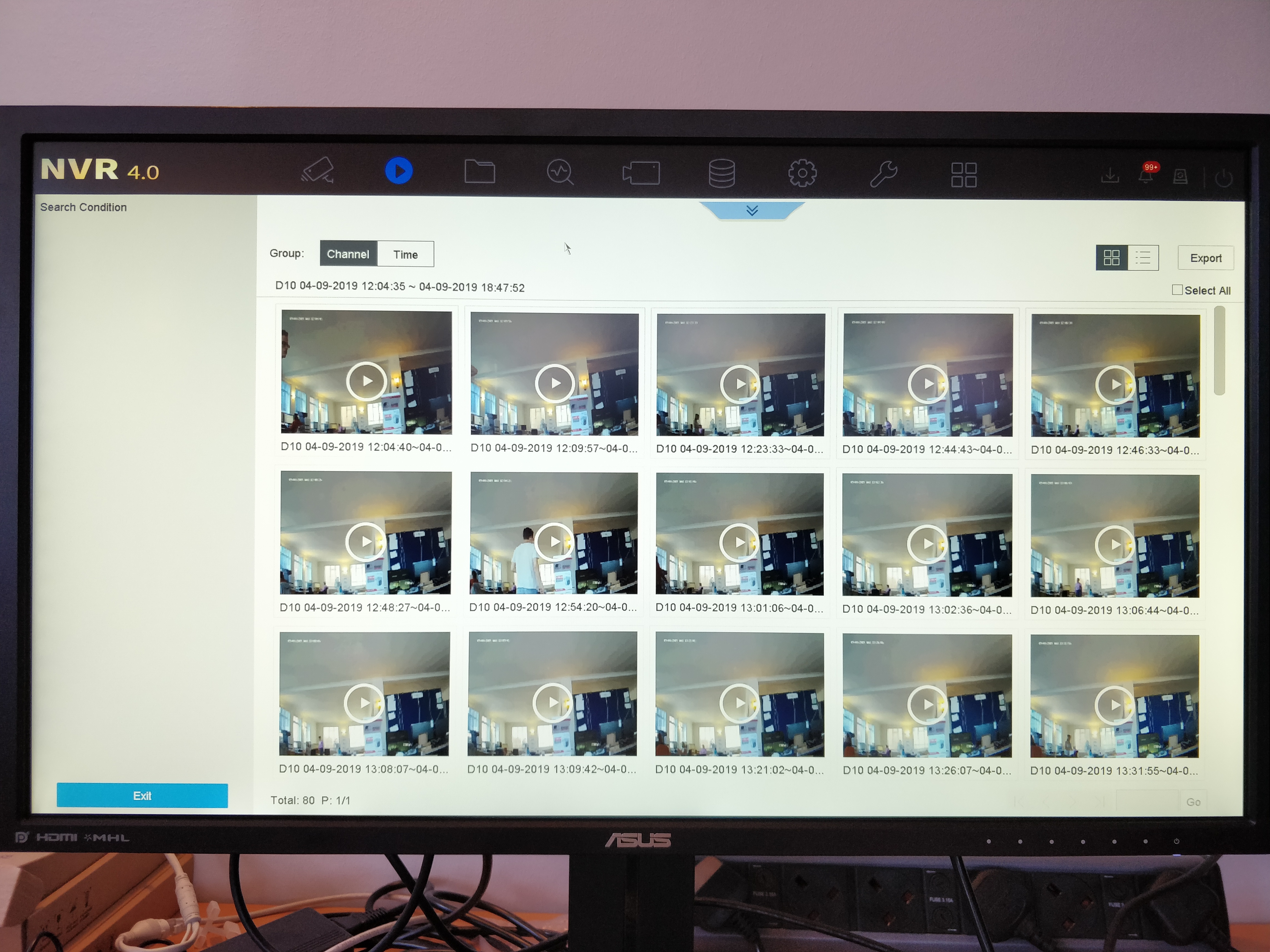

When you perform the custom search you will have 1 of 2 options as to how you view the Event notifications, you can either view them in a list format (see below) which allows you to select individual Event notifications and play them back, or you can exit the search and your search results will be displayed as Event markers on the playback timeline. Another big feature of both Smart & Custom Playback is the 'Play Strategy' menu (see below) which allows you to not only adjust the playback speed of continuous and event recording, allowing you to fast forward through non-Event footage, but you can also enable the 'Do Not Play Normal Video' function that allows you to skip over any normal continuous footage and only playback the Events. One final thing I should point out about the Custom Playback is that the search parameters stay locked in until you manually wipe them, so if you wanted to only ever use the custom search function for line crossing you can just leave a search for line crossing locked in. (although you may have to change the search date if you want to look for a specific event on a specific date)
