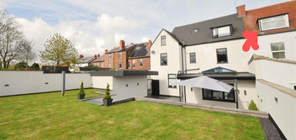

Currently have Hik DVR DS-7204HUHI-K1-P(D29400763)
One of the back cameras (DS-2CE56H0T-IT3ZE) was getting condensation inside so I am looking to change it.
The current camera is current powered by single coax so looking for like for like replacement.
Below is a pic to where the camera is and the area it's covering.
Ugh PoC (Power over Coax) is a shame as it limits your choice somewhat.
Your existing DS-2CE56H0T-IT3ZE is a 5 megapixel 2.7 to 13.5 varifocal PoC model. If you had a means to get a 12V DC supply local to the camera I'd recommend the DS-2CE79H8T-AIT3ZF as that's the equivalent ultra low light model. It's far better than your current camera as it has a minimum illumination of 0.003 lux (as opposed to the 0.01 lux of your existing one). Unfortunately Hikvision don't do an ultra low light colour/mono varifocal model that's PoC over 2 megapixel. The newer version of what you have is a DS-2CE79H0T-IT3ZE but the specs are similar.
