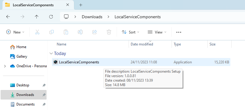

  1. Download the new plugin - latest today as per the above notification is here
  2. Note where it has been saved on your computer e.g. typically in your Downloads folder
  3. Shutdown / restart your PC
  4. After your PC has restarted and BEFORE starting your browser or any other program
  5. Navigate to the downloaded file
  6. Run and install the new plugin
This process should ensure that the new version is now used.
NB The downloaded file is a zip file and needs to be extracted before you can run & install it:
