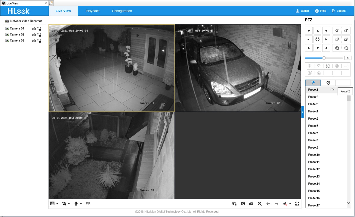

I currently have a HiLook system utilising a 104MH-C4/P NVR and three cameras:
Camera 1 is a IPC-D150H 4mm 5mp dome, mounted 2.2m from ground level
Camera 2 is a IPC-D150H 4mm 5mp dome, mounted at 2.2m from ground level
Camera 3 is a IPC-T651H 5mp motorised zoom turret mounted at 5m from ground level

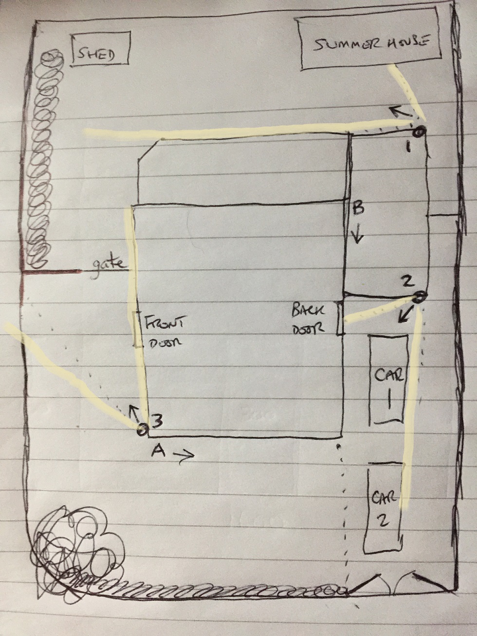

I am considering replacing the cameras with higher end Hikvision cameras to have access to the Smart Event features.
Replacing camera 1 and 2 with something like the DS-2CD2163G0 or DS-2CD2165G0 keeping the 4mm focal length.
Keeping camera 3 as is for the time being.
Adding a fourth camera to either position A to look at the second car or position B to look down the driveway. I'm not sure if one of the replaced cameras would be suitable.
The front door isn't covered particularly well but a camera would have to be fitted quite low down to see under the canopy.
To see over the side gate it would need to be mounted at 2.75m high and would be 3.5m away from the door.
Perhaps I could consider upgrading the NVR too? If I upgraded to an 8ch I could perhaps utilise all five camera positions.

Position A would be best for the potential new camera, as the camera deployed to replace camera 2 should give sufficient coverage of the driveway at 4mm (unless you decide to mount a Mini Dome beside the door instead).
