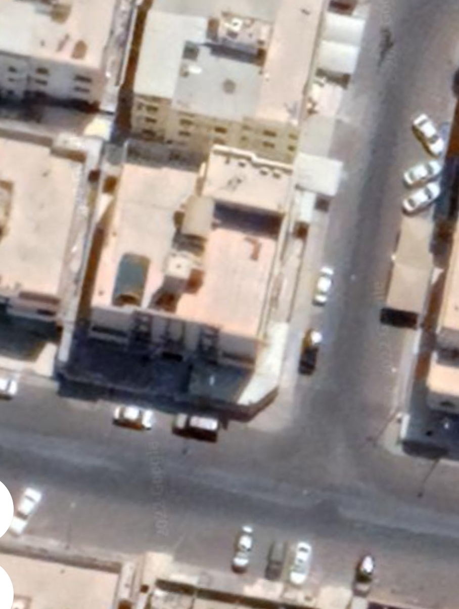

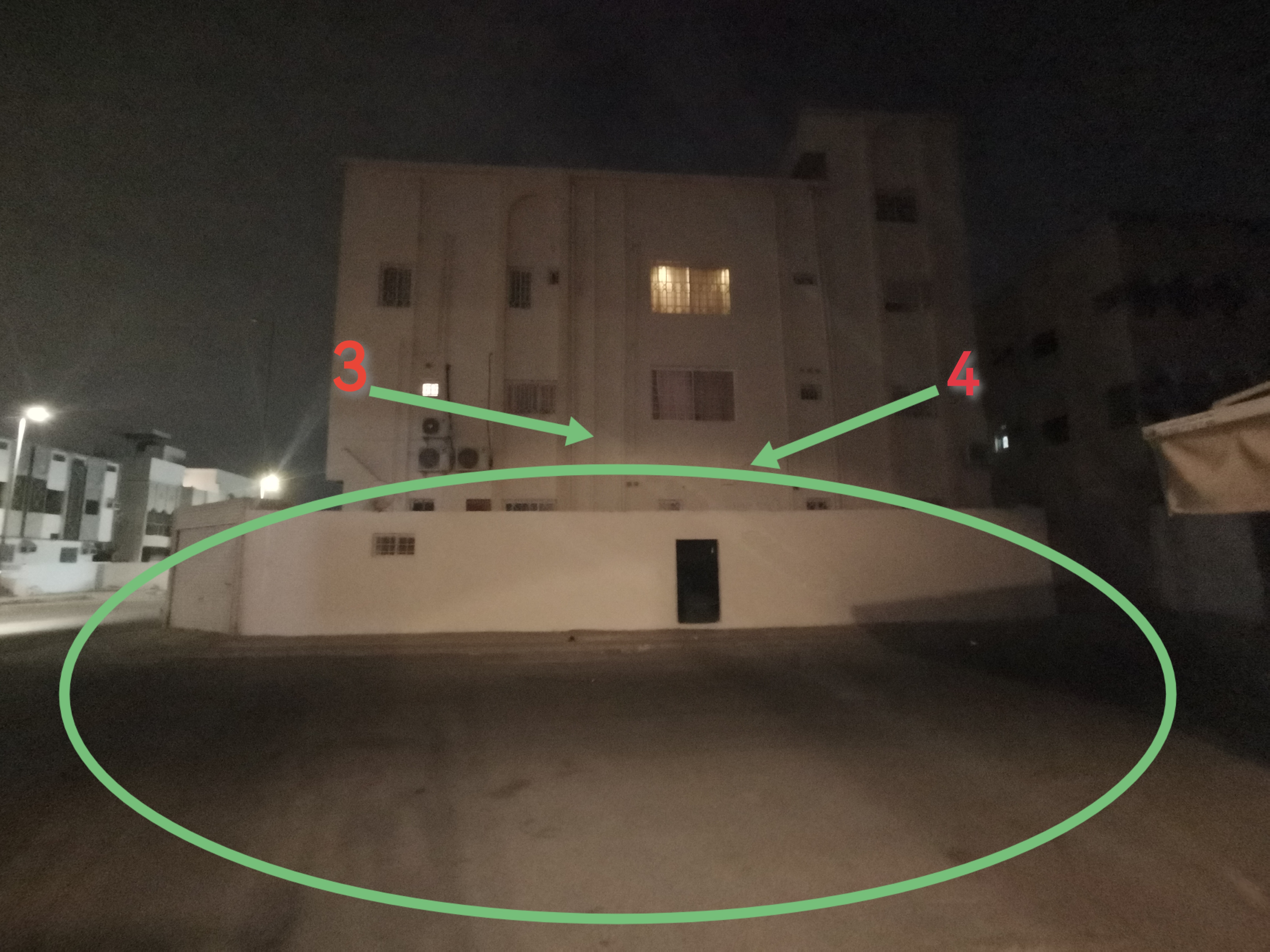

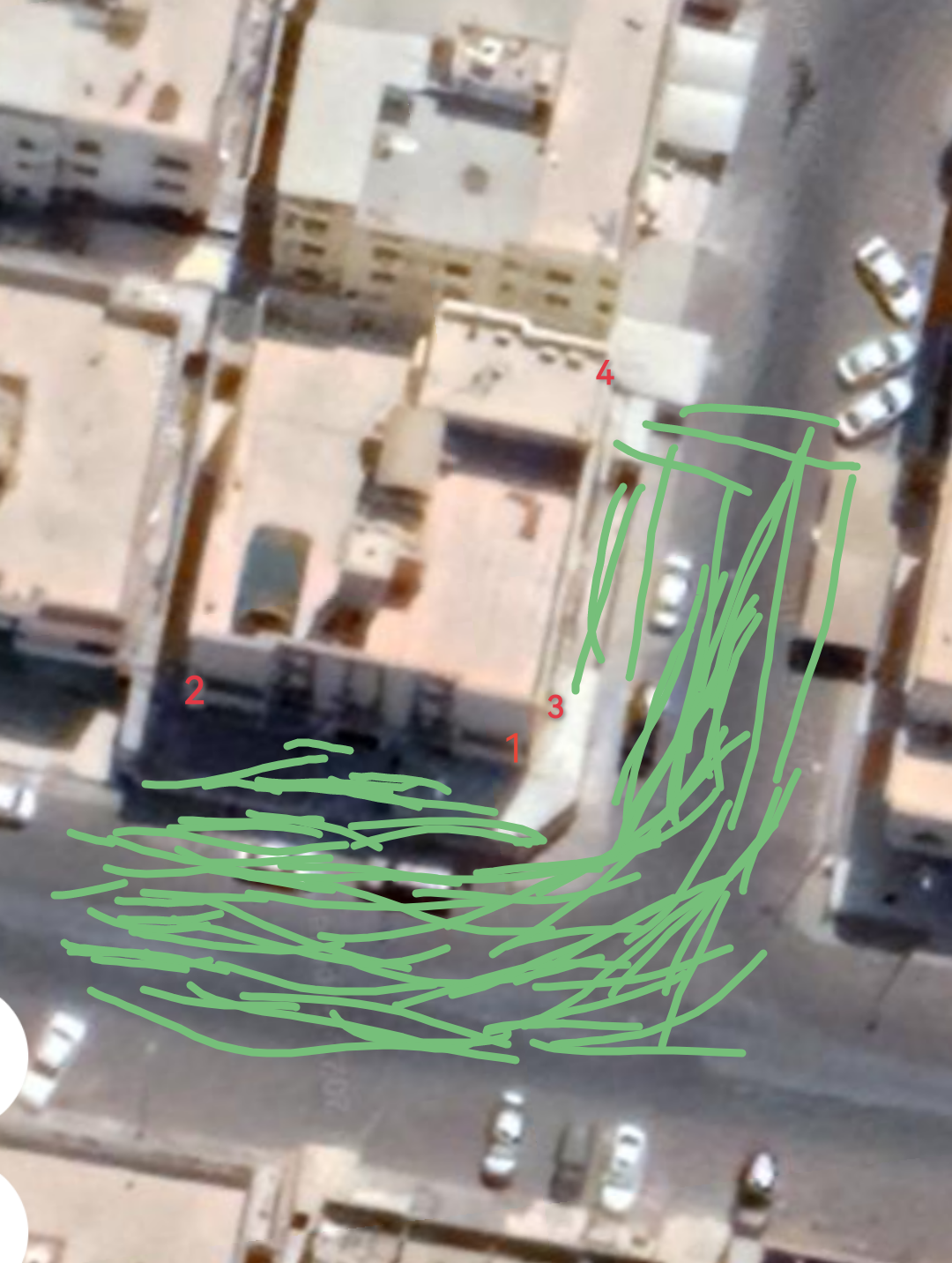

I am confused between 2.8 and 4 and these are pictures of my house on the nature and from the maps I will install 4 cameras in each corner, Approx 4-6 meters high .
I want it to cover the entire green area that I identified in the pictures.

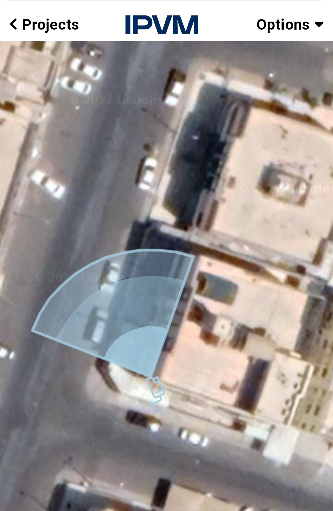

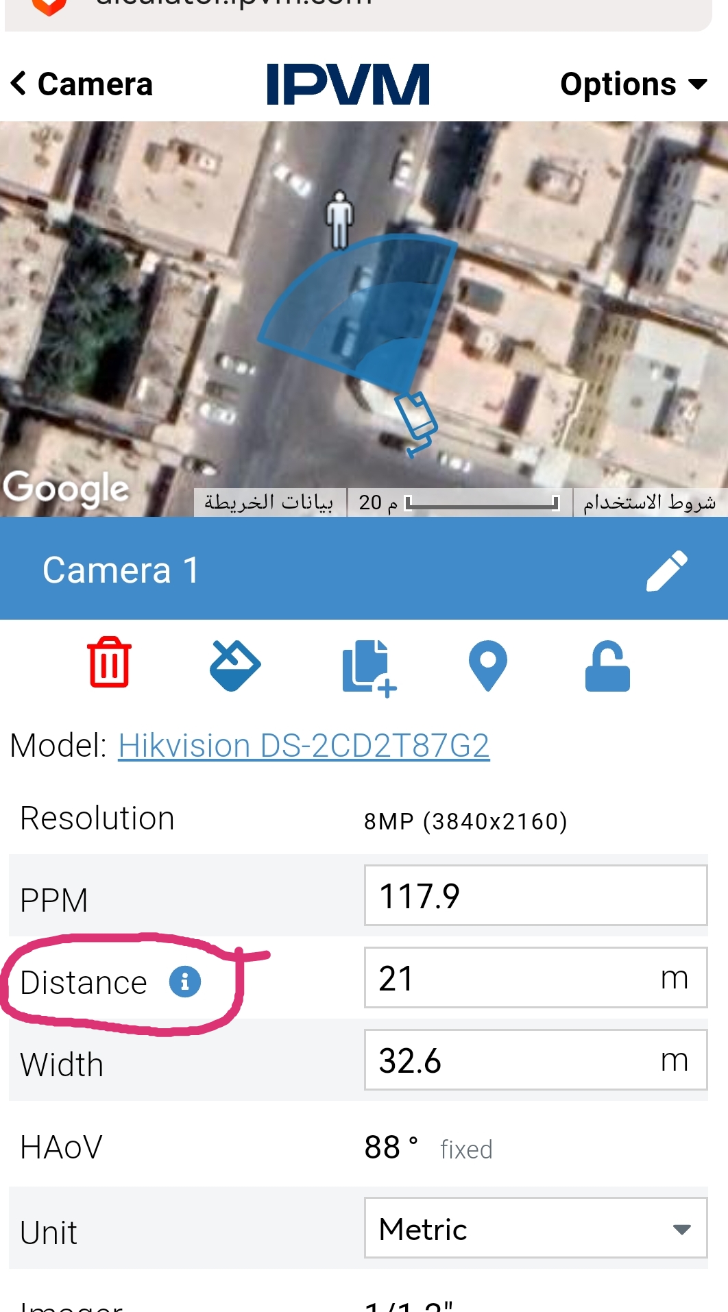

This is what I concluded when I placed DS-2CD2T87G2-L(4mm) on my house on the map
Is it accurate and will the camera 4mm coverage be the same picture?
But I don't understand what he means "Distance"، I was put it 21 meters.

Hi @Basim
I can understand your confusion over distance, the distance measurement is the distance between the camera and the furthest away object/area you want to capture.
What is key to understand is the different shaded areas of the cameras field of view, these areas represent the PPM (pixels per meter) and the level of detail you will achieve at different distances (darker blue is more detail / lighter blue is less detail). the below figures roughly explain the detail you will achieve in each of the 4 (or in your case 3) blue areas of the cameras FoV:
328ppm+ for facial recognition (dark blue / right in front of the camera)
164ppm to 327ppm for identification and LPR/ANPR
33ppm to 163ppm for people and vehicle detection (lightest blue section in your example / roughly 70-80ppm)
32ppm and lower for general coverage/visibility
So what this basically means is that at 21m from the camera you will be able to detect people & vehicles but not be able to make out precise details like number plates, items of clothing, or facial features. At about the halfway distance (10-12m) you can see the middle blue bar which means anything within that distance of the camera will be identifiable with greater ppm detail.
