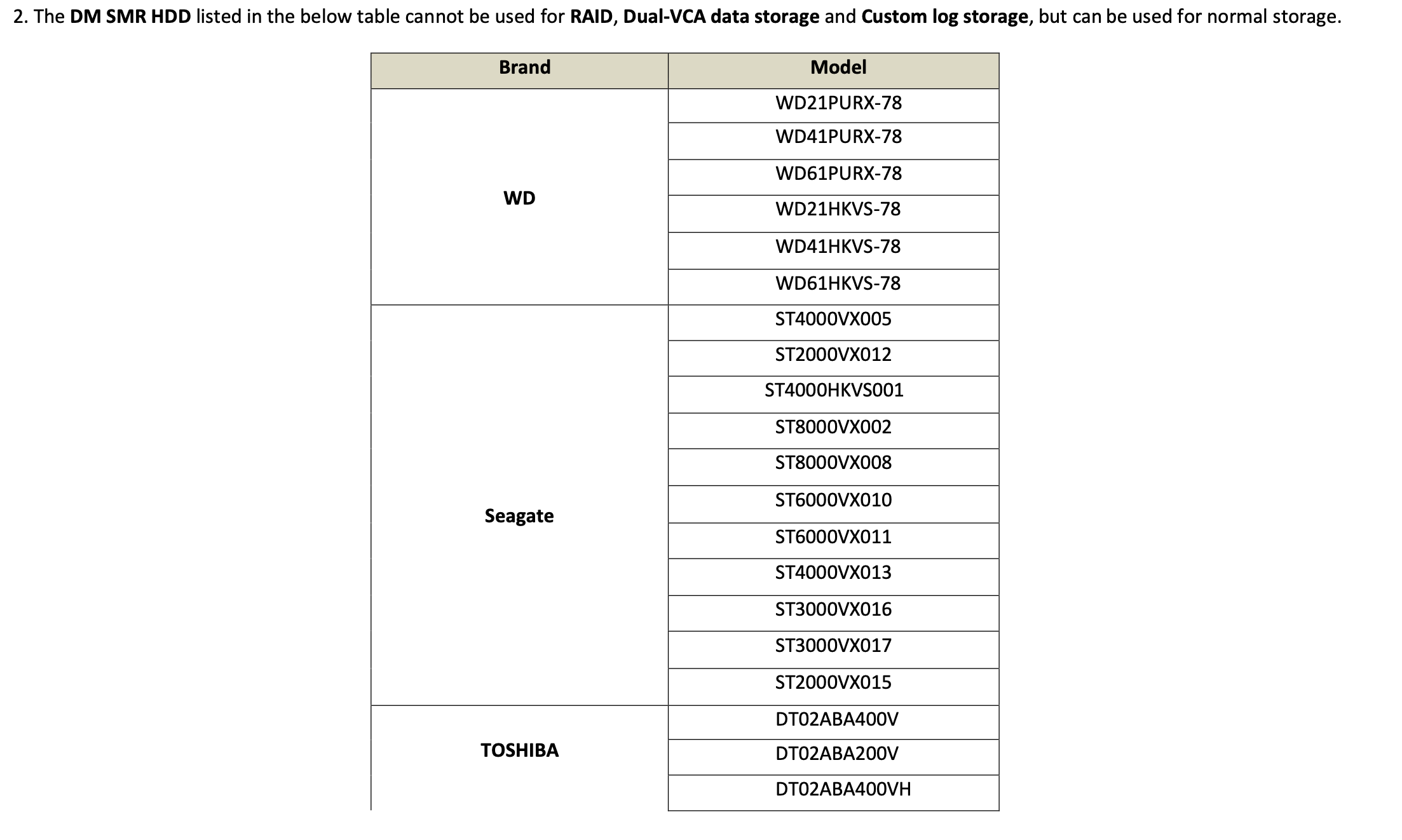

Generally Seagate Surveillance/Skyhawk are fine, Western Digital Purple are fine, Toshiba S300 Surveillance are fine. I say 'generally' because there are some exceptions:
- Toshiba S300 Surveillance - I found that these failed when using two in one machine. I was back and forth to a job and ended up replacing with Seagate. I did find reference to some issue on a Hikvision document somewhere.
- WD Purple/Seagate Surveillance - I've always used these as its what my supplier installs when supplying pre populates DVRs and NVRs. However I saw the following on the compatibility list and later found that I had unknowingly installed one of the affected Seagate Surveillance models affected:
So the above will work but not save the VCA data that the camera can send alongside the video stream. It's this data that's saved by the NVR and used when performing a search for line crossing or motion detection in a user defined area of the image.

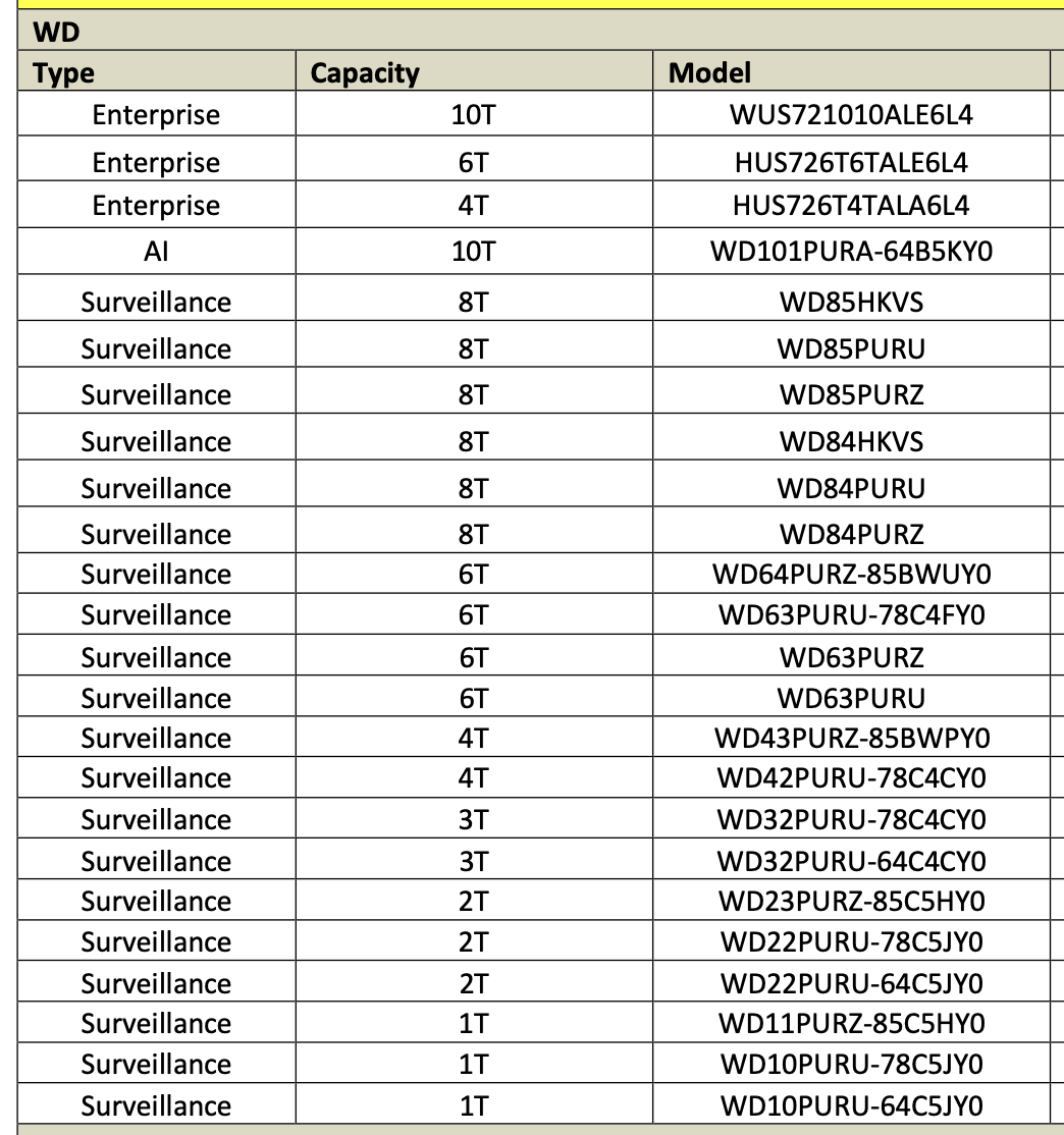

The following is an excerpt of the HDD compatibility list for the model you've ordered. That's not to say that your intended model won't work, that's very unlikely but the list is what Hikvision have tested and deem to be compatible:
Thanks again for the reply. For some reason I typed the wrong PN in post #10.
I did order the 6TB ENterprise drive listed in your second chart, PN: HUS726T6TALE6L4.
